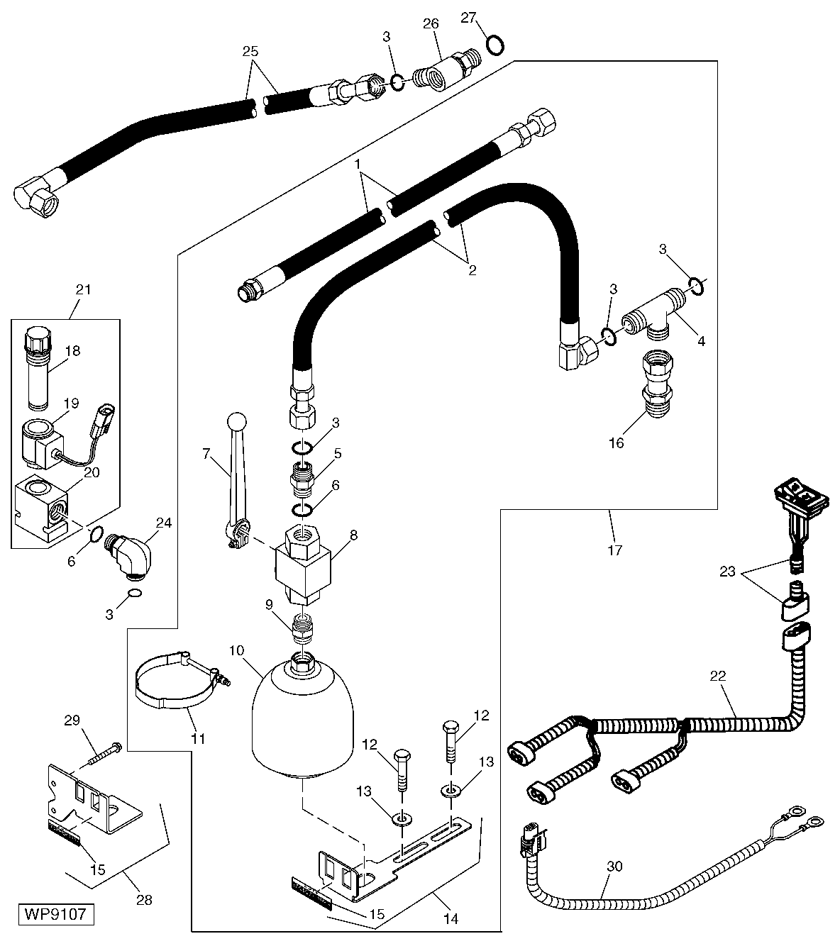

Yes, at least on the surface the JD system and the WRL system look similar. The WRL picture at the link in the first message shows their comfort ride activated by a hand lever. Most of these damping systems use an electric solenoid and an on/off switch. I think I'd prefer that.
Was thinking the same thing. A single solenoid valve isn't much more than a ball valve & would greatly improve the utility of this.

FYI- Here is a diagram of the JD system. The Deere system comes standard with the mechanical lever, and they have the option for the solenoid valve AW34007. They want $395 for the valve, not including the fittings, harness and switch, so that option must price out higher than WR Long's entire product.

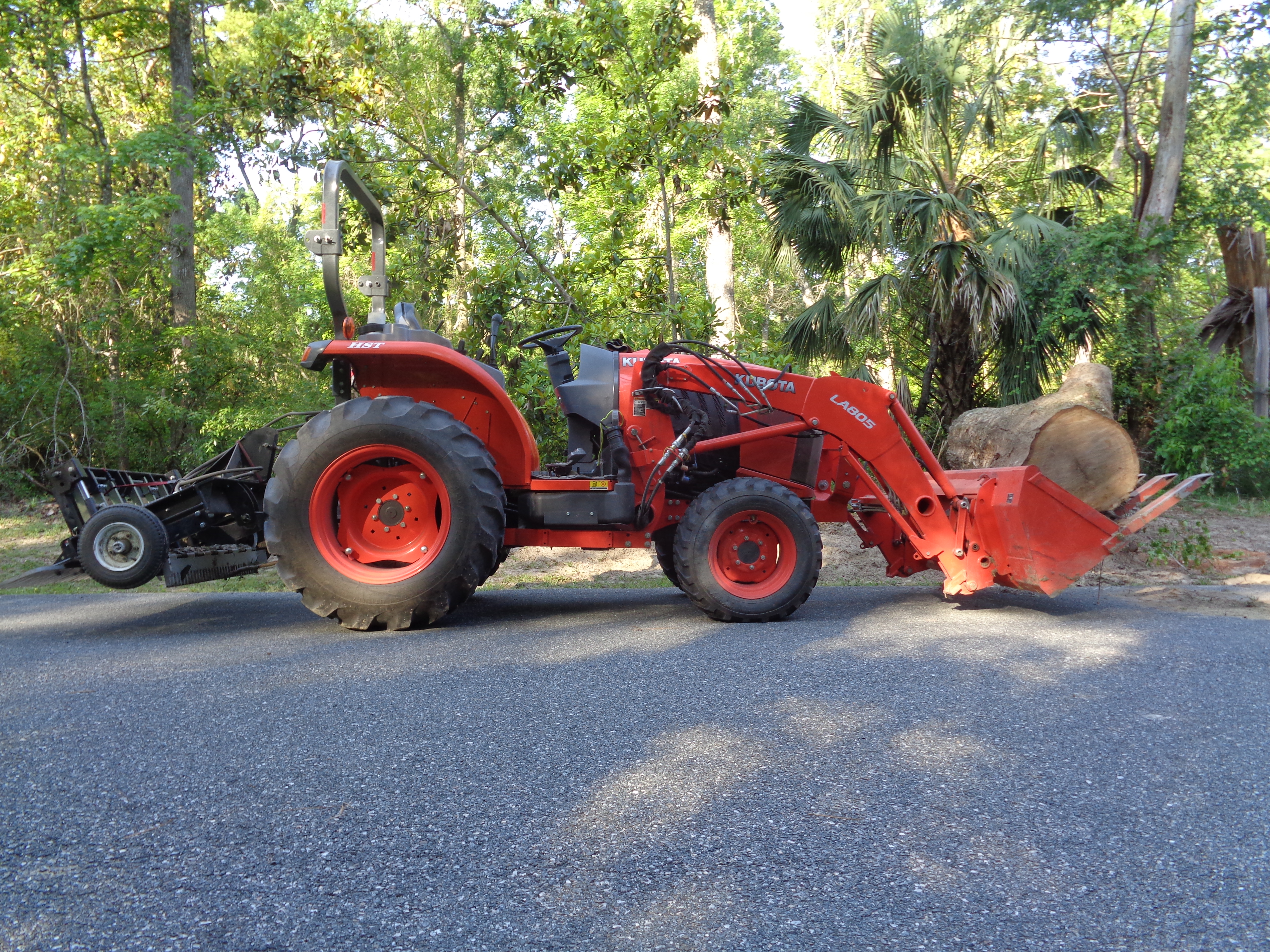

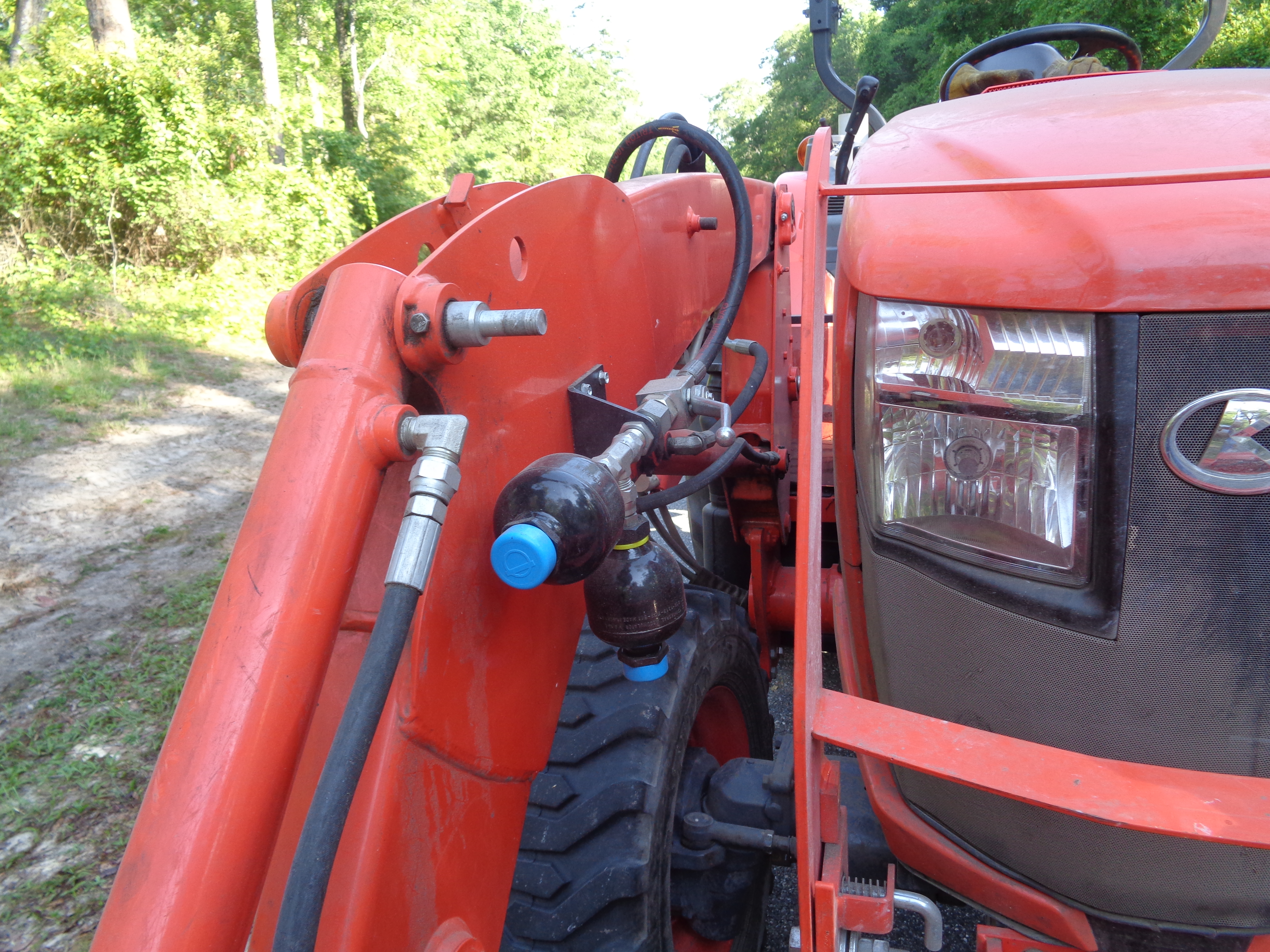

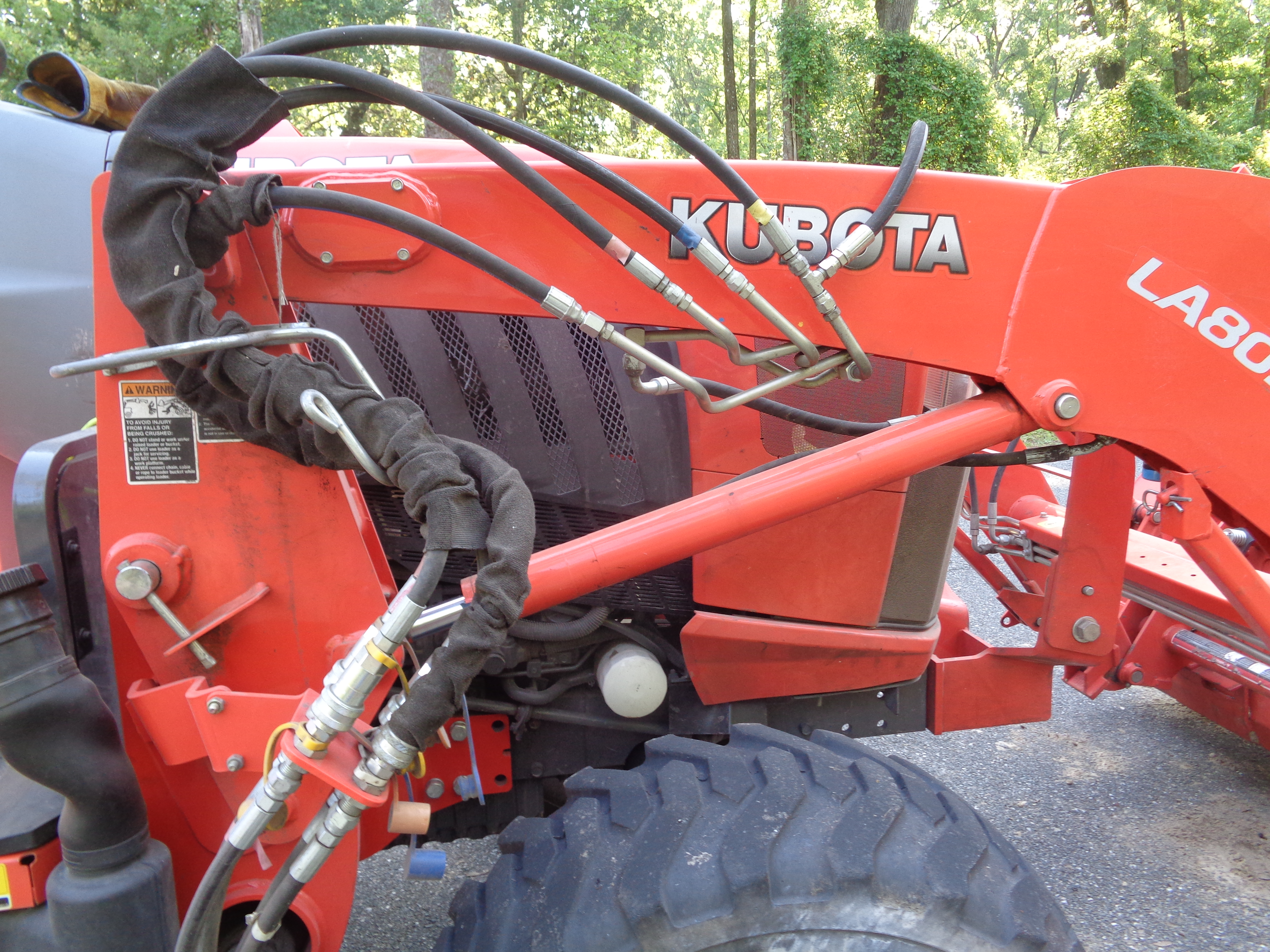

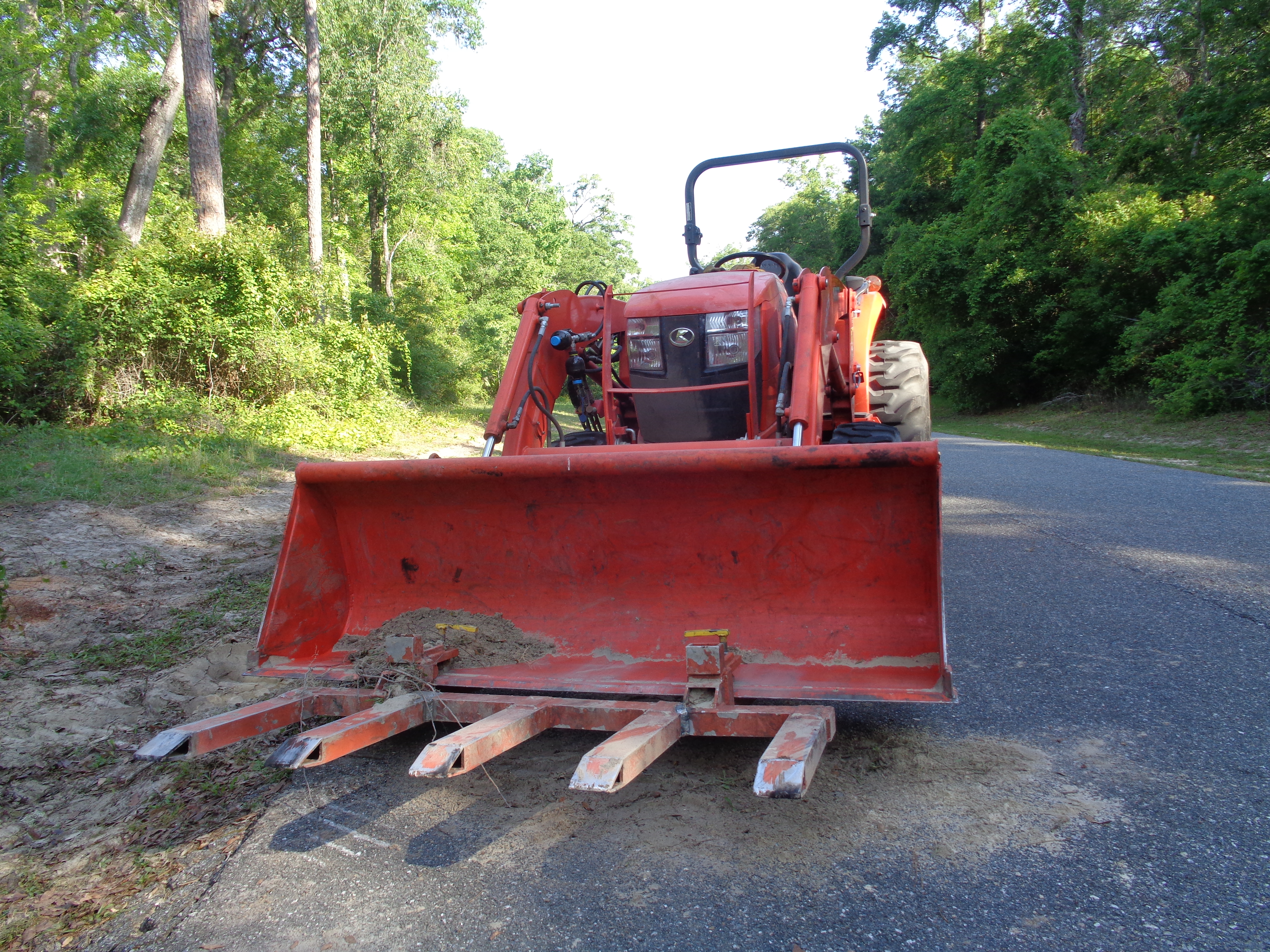

Kubota dealer installed the CR10 on my L3560 with LA805 FEL.
I have been moving heavy hurricane tree debris to our community burn pile.
Works as advertised. With moderate loads of brush on Debris Forks damping actions reduces material falling off during transit.
One hydraulic line had to cross the right loader arm in my installation. Picture soon.
Pictures.
I do not know why I would choose to close the accumulator valve.
With CR10 working, bucket does not pound, burdened or unburdened.
Oak section guesstimate 1,200 to 1,400 pounds. FEL (LA805) lift capacity 1,700+ pounds. I cut large diameter Oak loads to fit in the bucket, near to the tractor, rather than on the forks, where leverage works against stability. Three Point Hitch counterbalance 900 pounds. Much less transient load stress on the tractor with Long's "Comfort Ride" cushion-accumulator installed.
Haynes aluminum Debris Forks, no longer in production.
I am still burning debris from Hurricane Irma in September 2017.
