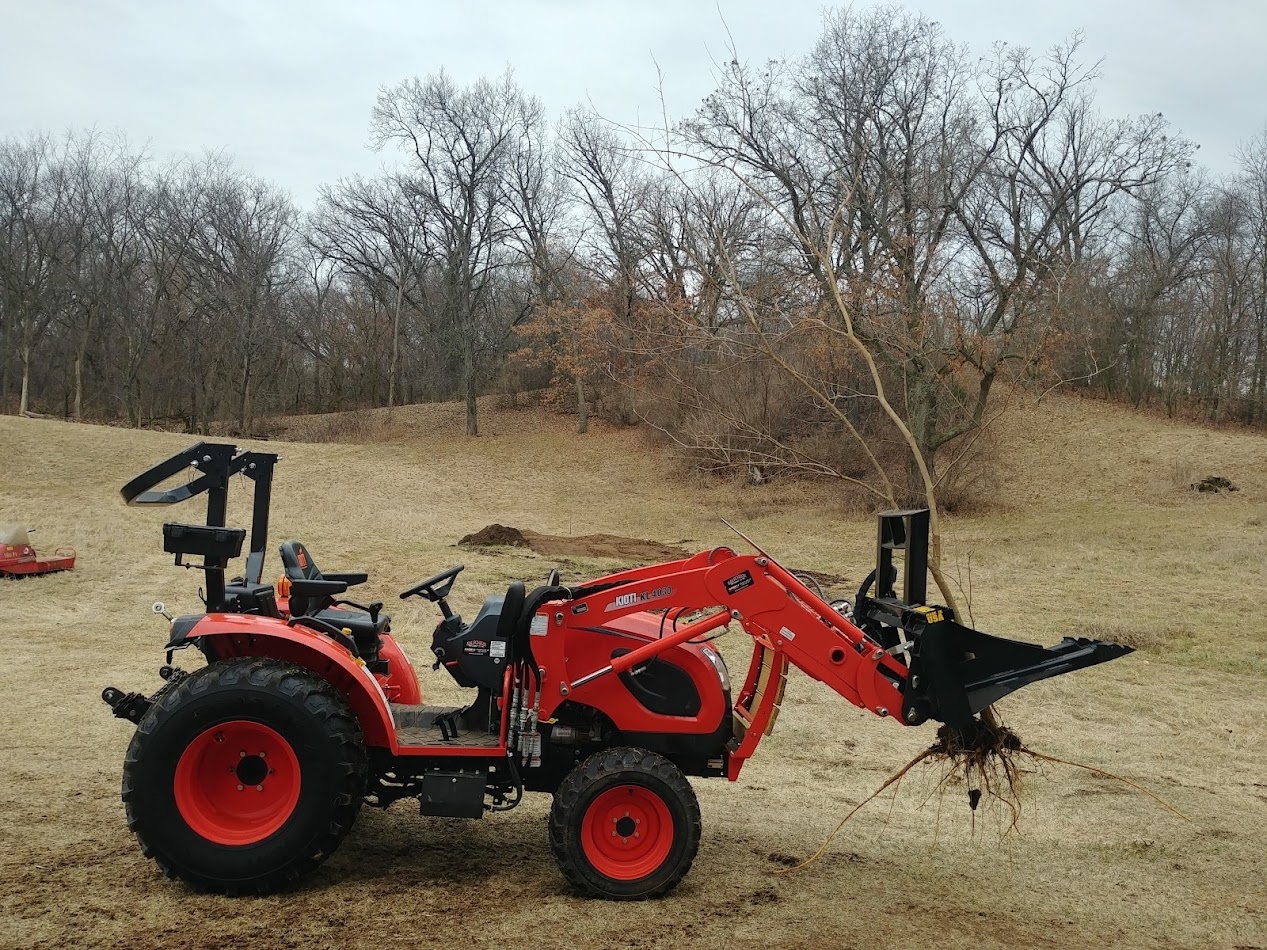

My TYM T474HC showed up this past Friday, and the only implement I got extra was a pallet fork. So I am looking at implements (not sure what is considered an "implement" and what is considered as an "attachment") on a prioritized basis of what would be most useful right away. Right off the bat, I can see where having a combo stump bucket and tree puller would be VERY useful to me, as I have some stumps from prior cut trees, and many small trees and saplings that could be just pulled out of the ground, rather than cutting than digging up the roots. So a tool that could tackle both would be ideal. At least in my humble opinion.
The T474 weighs 3,660 lbs. 48.3 HP at the engine. FEL lift capacity is 2,152 lbs at pivot pin. Breakout force at ground level is 3,198 lbs.
Yeah, I could get separate units, but it just seems logical and reasonable to have one tool to do both, even if some compromise would be needed.
Any input on which model/manufacturer would be the best fit for such an animal?

Love my Danuser Intimdator. Use both on a Kubota B26 and M59. Grip low, drive forward to break it loose then lift and curl. Can excavate when you need to. Pile and carry.

Another approach is to buy a tree puller $1390 and separately buy a stump bucket $890. Tractor Attachments — MTL Attachments Not saying it's the best, but it should be functional.
However, if it were my new tractor, (1) I would want to get past the initial break in period before doing very hard work and (2) I would personally be reluctant to dig out stumps and tree roots with a stump bucket because that's going to be hard on any tractor front end loader. Maybe your soil is loose enough, but I don't know how this will go for you. I'm mentioning this as a precaution to consider.
I might also mention that I feel conflicted whether I'd recommend a grapple as a first purchase over a tree puller. If you have material that is already down that needs to be moved, the grapple would be my choice for that. However, if you want to yank out smaller saplings one at a time, then the tree puller would be better for that. Usually, this will go more easily in the Spring when the soil is saturated with moisture.
One of the guys here made a bracket for his grapple that allows him to pull small saplings. That is another option to consider.
For a new tractor, I'd very much recommend as an initial priority that you add a brush guard for your front grill and possibly filter guards under your tractor to protect any filters that could be damaged by brush. (I spent 4-6 weeks fabricating guards for one of my tractors before I put it to work moving brush.)
Congratulations on your new T474. I hope it serves you well.

A tractor FEL isn’t the right tool for digging stumps. It’s easy to damage one doing that. If you do want to move forward the Danuser puller is a nice tool. But it’s 5k. You could probably buy an economy puller and a dedicated stump bucket for half the price.

I ended up getting a stinger stp-34 tree puller for clearing prickly ash, buckthorn, honeysuckle, mulberry - invasive brush that had taken over the woodlots and fencerows. It does a real good job at that, and I was able to clear large swaths of 2-3" or less. I would pull an area, then come back with the grapple and gather into piles to burn later. The neighbors of course noticed what was going on, and by the next year I see at least two acquired their own and started clearing their places. The one I got supposedly has blades and barbs on the front for digging, as in digging roots and stumps, but I wouldn't recommend using it for that with a FEL. You could, but it's not the right combination, not very effective, leaves a mess of tangled broken roots sticking up, too easy to screw up doing it wrong. If it's that hard to remove, just cut it off at the ground and leave it. Even if you put it on a skid steer, which could handle that type of work better, I'm not sure I would because of the mess it leaves behind. Better to cut it off flush, and let the stump rot away until a nudge with a bucket or pinch with the grapple can push it up and out.
