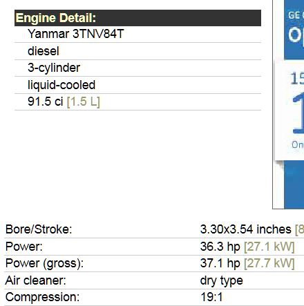

That's good cold weather starting for a turbo engine that has lower compression(19:1) than a naturally aspirated engine according to DarkBlack!!!
