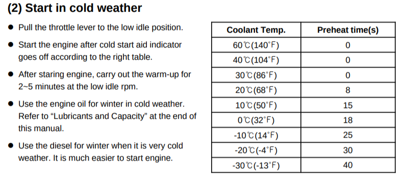

I am following this as I have an XR4150 and the light stays on longer if it is colder. Summer on a second or two. Yesterday, about 10 seconds. Hard to believe they would take that out of a newer tractor to save a few cents.

@mred2, They haven't on my MT240, this is from the manual and seems accurate as far as I can tell with my moderate (30's F) temps.
