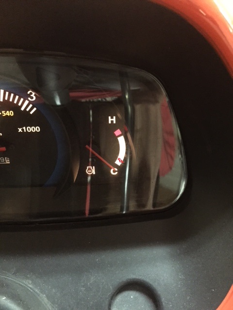

I was out using the tractor off and on for a couple hours with some idle time in there also. Here is a picture of my temperature gauge, it is cold in the picture because it is sitting in my shop but when it was running it was sitting around the red mark that I very poorly drew on there in paint.

thats about where my tractor sets after letting warm up for 10 minutes in sub 20 degree f weather. If Im putting it to work, it gets warmer but not much. My last tractor was a Mitsubishi with 4 cylinder diesel and the temp gauge only started above 120 degrees f. In the cold of winter I could use it for hours and not burn my self on the exhaust pipe, it was only "warm".

That sounds about right with what mine does. Maybe that's just normal.

In the photo the op posted the hand drawn red line is in the white (normal) zone so the engine is getting up to operating temperature.

That Mau be true, but it is still on the "cool side" of normal. One would think and most motorized pieces of equipment (cars, trucks, tractors) get a little warmer than that. That almost indicates a thermostat stuck open or op didn't allow it to warm up good and or didn't operate the tractor long enough to warm it up good.
