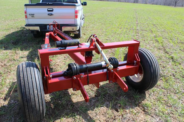

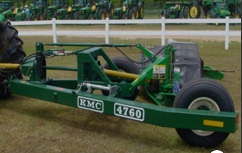

No problem I'm getting on up there in age @ 77. I didn't notice your reply. It appears sea2summit answered your question. Disk cutter caddy's come in several variations with tires/wheels in a straight line & offset(see photo below). Also some have hyd cylinder operated 3 pt attaching mechanisms in order to raise/lower cutter.
For my purposes utilizing my Krone cutter I just set the that 3 pt mechanism control cylinder on caddy to desired height & don't change that cylinder rod extension again. Cutter on caddy is easier to attach to tractor, puts less strain on tractor while transporting cutter between fields & I think cutter follows ground terrain better than when mounted on tractor

I skipped over all the caddys & trailers and went straight to road speed tractors. :)
Too many times I’m by myself and just want to roll with one unit. No assembly/disassembly required :)
Nothing against doing it with caddy’s & trailers. I would want to wait until I’m way over width and then switch to one of those. If I’m 12’ or less, I’m roading.

But you can hook your caddy to your wagon to your baler vs just having the mower on the tractor....that saves a lot of trips.
But my real reason is I think the cutter was too big for my tractor, dealer said "I wouldn't go any bigger" and after the first ~100 acres I was more than ready to get it off the tractor before something broke.
