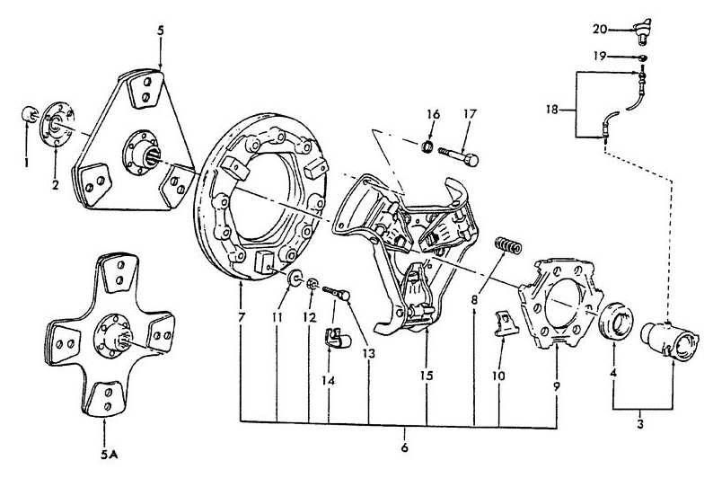

Similar situation here except I only have one 73 Ford 4500, using the same 6x4 speed manual transmission, engine, throw-out bearing, and pressure plate. Clutch does not engage even after adjusting the linkage all the way in both directions. After rebuilding the 201 diesel engine, I installed a new 4-pad cross shaped clutch. Since I didn't know to look at the direction that the protruding hub was facing when I removed the engine, I had to do some research to find out. I concluded that the hub should face the pressure plate/transmission (see below), but now I'm still not sure if that is correct. Please help!
For those who may have come across this same issue, I found out the hard way which way the hub should face. Even after some lengthy research prior to installation, the following information eluded me until after I installed the clutch incorrectly the first time. The key is determining whether you have a previous type clutch design or a current type clutch design. As noted below, this can be determined by establishing whether you have an external or internal clutch pedal return spring. A current type clutch design has an external clutch pedal return spring, which requires the side of the clutch with the longer hub protrusion to face towards the flywheel in most cases. See the following attachments for your specific application.
