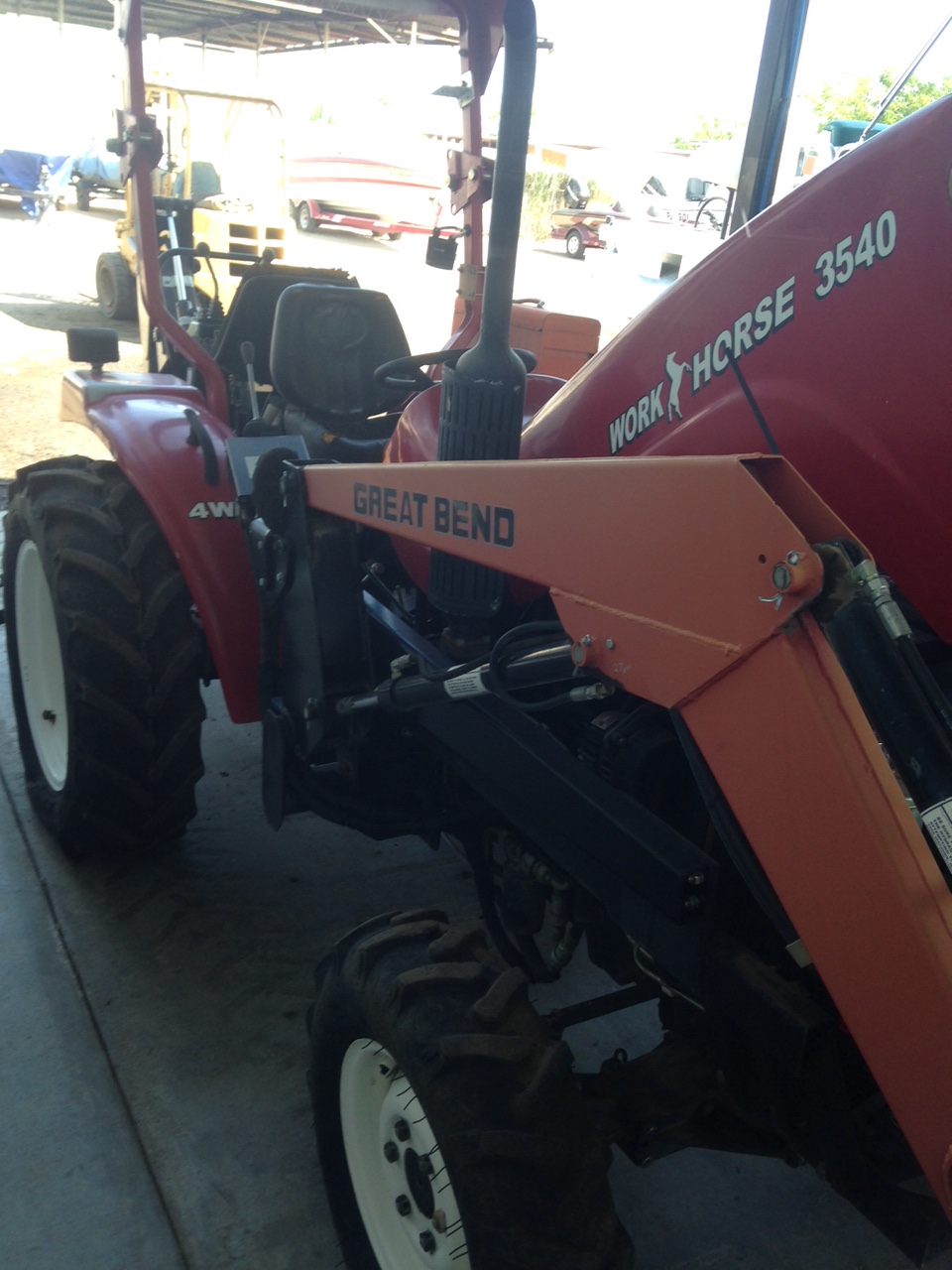

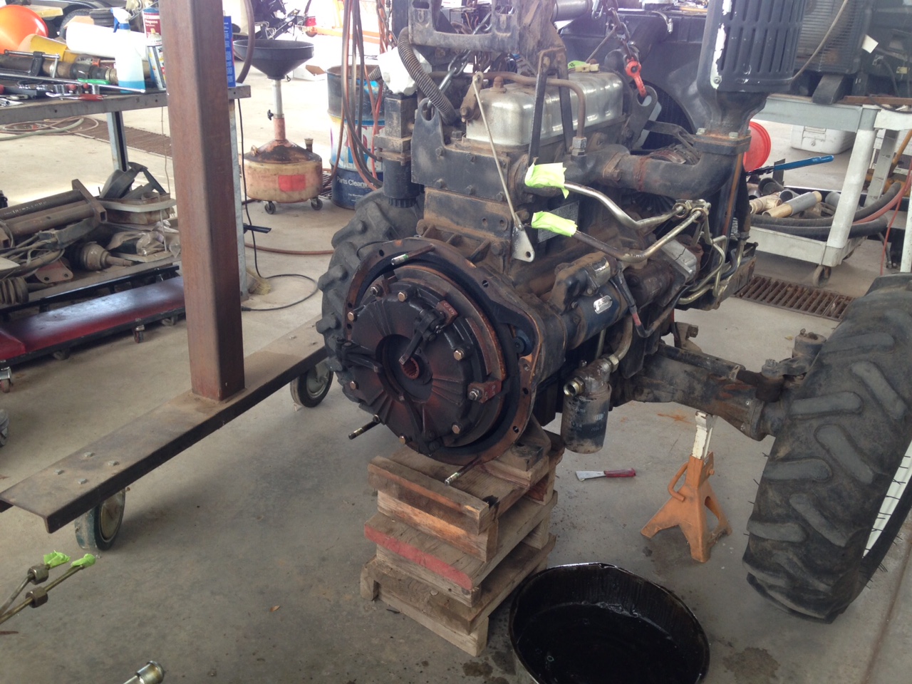

Have 2005 35Hp. Jinma with loader and backhoe. Is it best to remove the implements first ? I feel the loader for sure but not sure about the backhoe .
Thanks, Randy

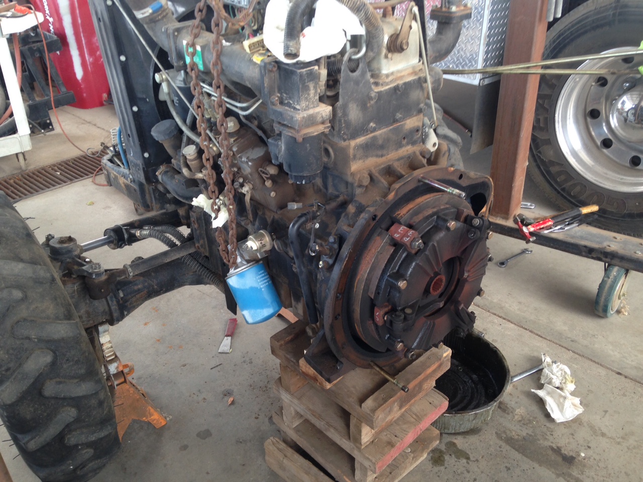

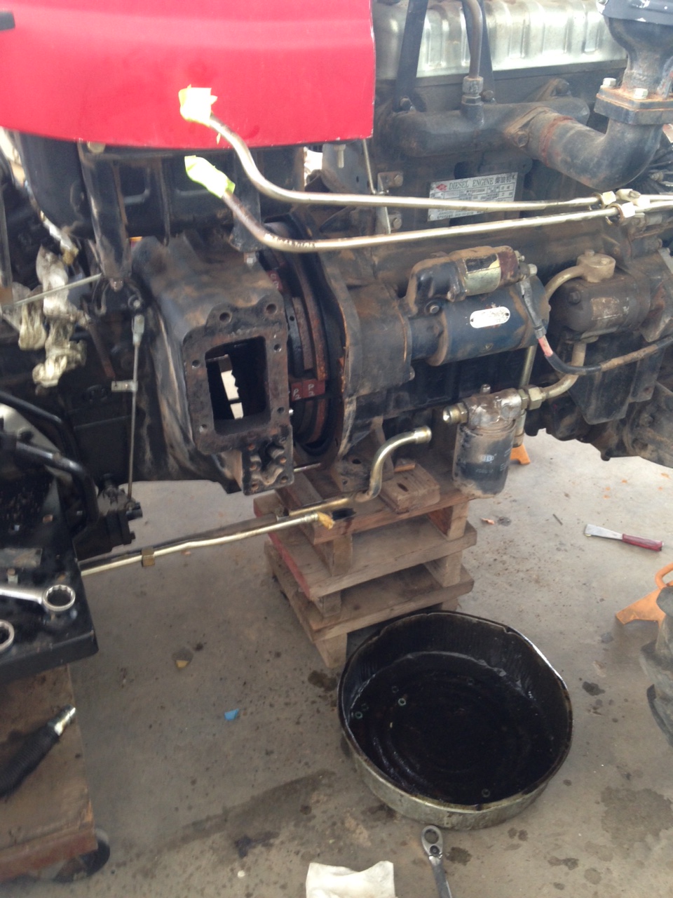

When you split the tractor you have to roll the rear apart from the front. Normally I block the front wheels and engine and support the transmission and rear wheels and roll them away. It would be hard to do that with a backhoe on.
Loader definitely has to come off, the mounting brackets are in the way of the transmission bolts.
If you search in the Chinese Tractors format there is a posting titled Jinma Splitting Guide. It's based on the 354. You should find it very helpful.

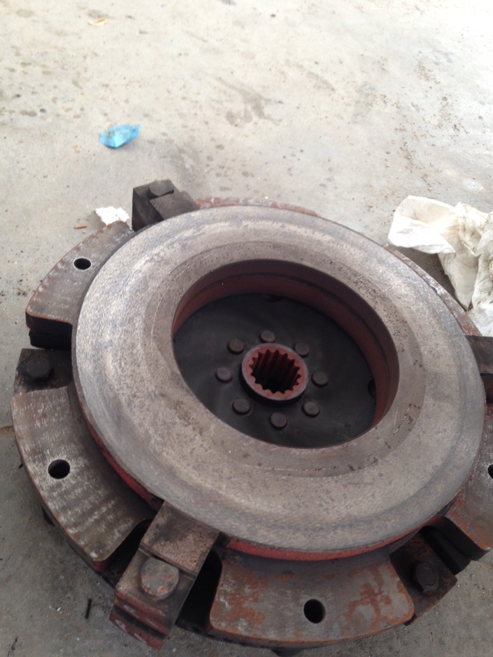

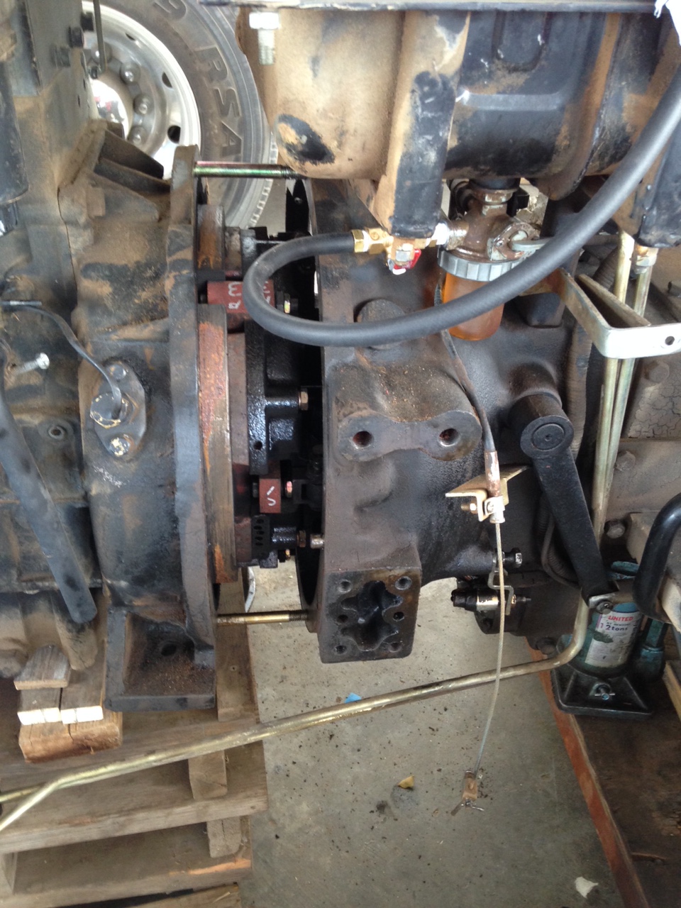

Not much of a righter so here are some photos of the split. She is a 354.

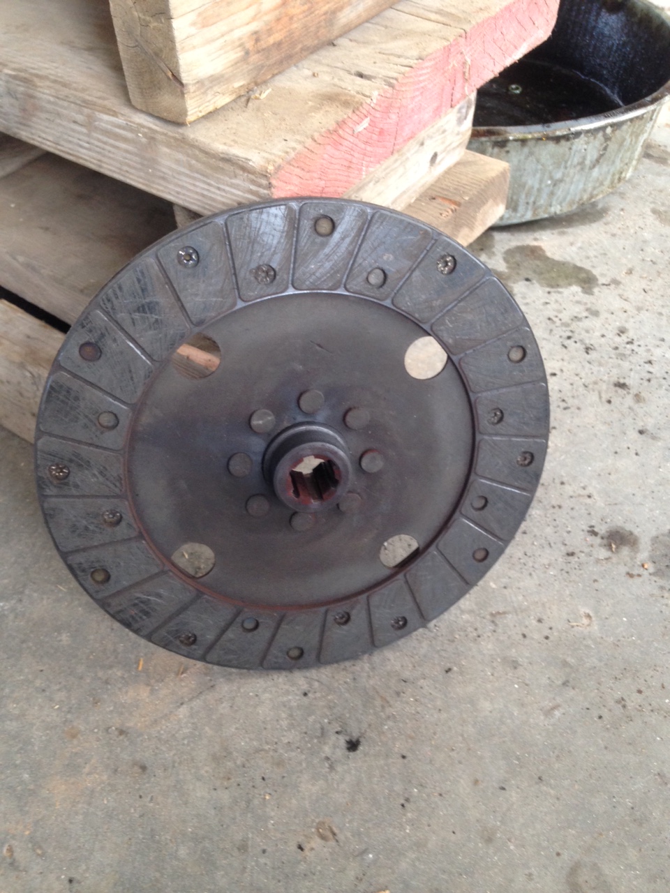

   / Clutch replacement on a Jinma.
Only problem with the split is the clutch looks ok ? Same with the pressure plate?

   / Clutch replacement on a Jinma. #6
What were clutch symptoms before the split? Slipping? Grabby? You're right the parts look ok at first glance. A smoking gun is preferable.
Thanks Jim.
Loss of power on pump for backhoe pump slipping ?. PTO. But the drive clutch is down to the rivets. My-bad ! Was using the clutch like a car. But I learned to split the tractor.
After things get cleaned up I will go back through the adjustment . Maybe I had the PTO setup wrong ?
Most will have the front drive-shaft housing boot going bad. So I went with a pluming part. We will see if it works ?
