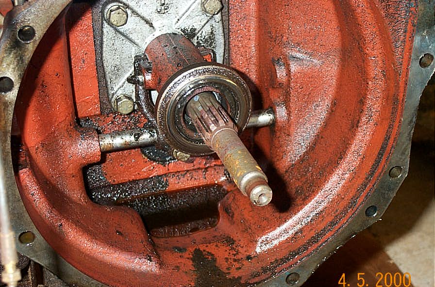

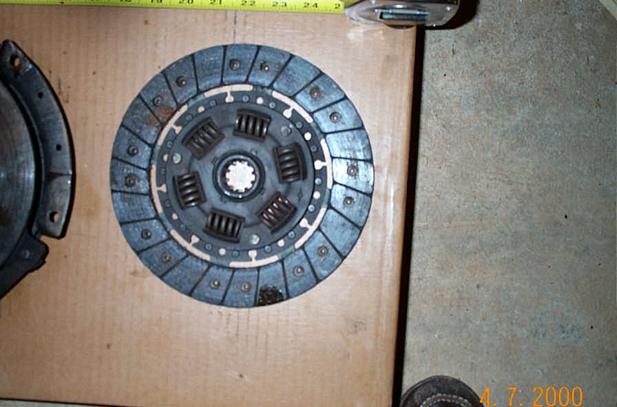

Hi All,
I am looking for a part source for Daedong tractors, I have grey market (to US) Daedong tractor L2601 which has daedong 1400cc 3 cyl diesel and 4 wheel drive, looks very similar to a LK3054 but only has 1 stage clutch. So I am looking for parts for the Clutch, the friction plate, throw out bearing , transmission main shaft seal (cause of my clutch problems) and maybe while I have torn apart the pressure plate and diaphragm spring (attached to pressure plate). Can anyone help me out?
Thanks,
Thud
   / clutch for a Daedong L2601
#2
wanted to add some pictures so maybe they might look familiar to another model.
Thanks
Thud

   / clutch for a Daedong L2601 #3
Thanks for the advise, I may have to end up doing that, but I have to believe that Daedong made this same clutch for other tractors that were shipped to US, but the things aren't marked with a part number, that would be too easy huh?

To follow up on this,
I found a clutch plate on ebay it was for a Kioti LK2554 the part number was T38284-14301 and it was an exact fit (although the people I bought it off said it for a LK2254 which as far as I could tell doesn't exist ;-). The throwout bearing (thrust bearing) was a Koyo RCT45-1S, and I found that through a bearing supply house, the transmission seal was metric oil 25x52x10 type TC and I bought them through a oil seal supplier in California. So I should be back in business soon.
