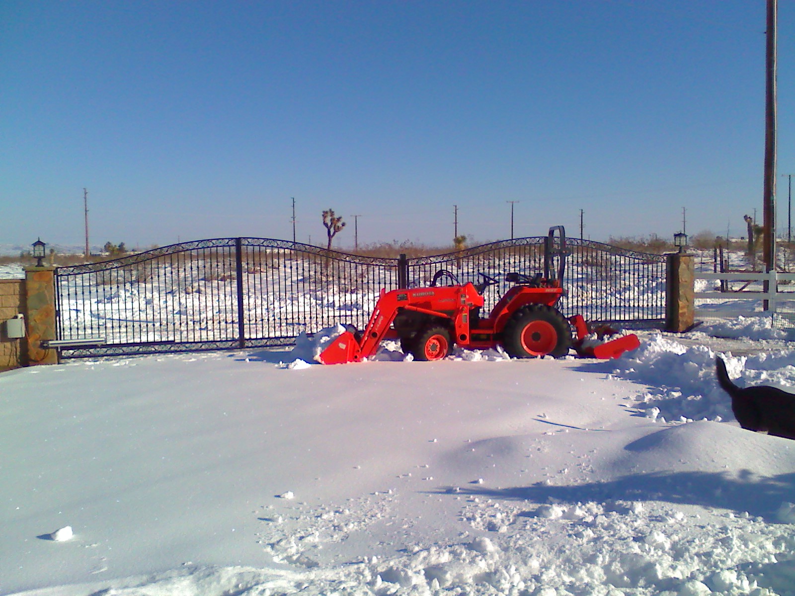

Hello All,
I built a block wall with 6' x 18"colums that my entry gates are mounted to. I installed 3/4" conduit taped on both ends. I went to install the light and found the pipe is blocked with concrete down at or above the 90 which is 16" below grade.
Iv´e tried jamming a piece of 3/8th rebar, using 4000PSI pressure washer, air compressor and whatever else I could find that would fit.
I hope the pipe didn't come apart inside the column but the more I try and fail it seems this might be the case.
The attached picture shows the column on the right side of the driveway with the light on top (For looks Right Now).
If anyone has some idea's, short of tearing down the column please let me know?

Looks like you (or the company who did the stone work) will have to start digging. At least it is below grade so you won't damage the nice looking stone. I'm thinking you have a pretty good size footer due to the large gate so this can be a royal PITA to chip out part of the footer. Good luck to you sir!!! Keep us informed here (with pictures please) how things are progressing.

Very nice looking gates and entry. Have you considered checking on the rental availability of a 3-4 inch round diamond tipped hole cutting tool like those used by plumbers to cut holes for pipes in block/concrete walls. Depending on how thick the footer is at the 90 degree turn point you may have to drill 2-3 inches and then chip out the core to gain access to the 90 degree bend so you can remove it. You should then be able to snake or fish the wire up to the light. I don't think I would even consider tearing down the column.

Dave1949, I've tried top and bottom for approach, the problem is if I shove something in from the bottom it either snags on the bell end of the 90º or is not rigid enough to knock free the obstruction. I appreciate the comments on the gates!
Gator6x4, Thanks,I will look into the mentioned tool. The footing is 24" square x 28" deep the PVC 90º's out mid footing. You did give me a idea, I could core drill like you said except go thru the PVC then use direct bury cable run that from the exposed PVC end to a junction box.
