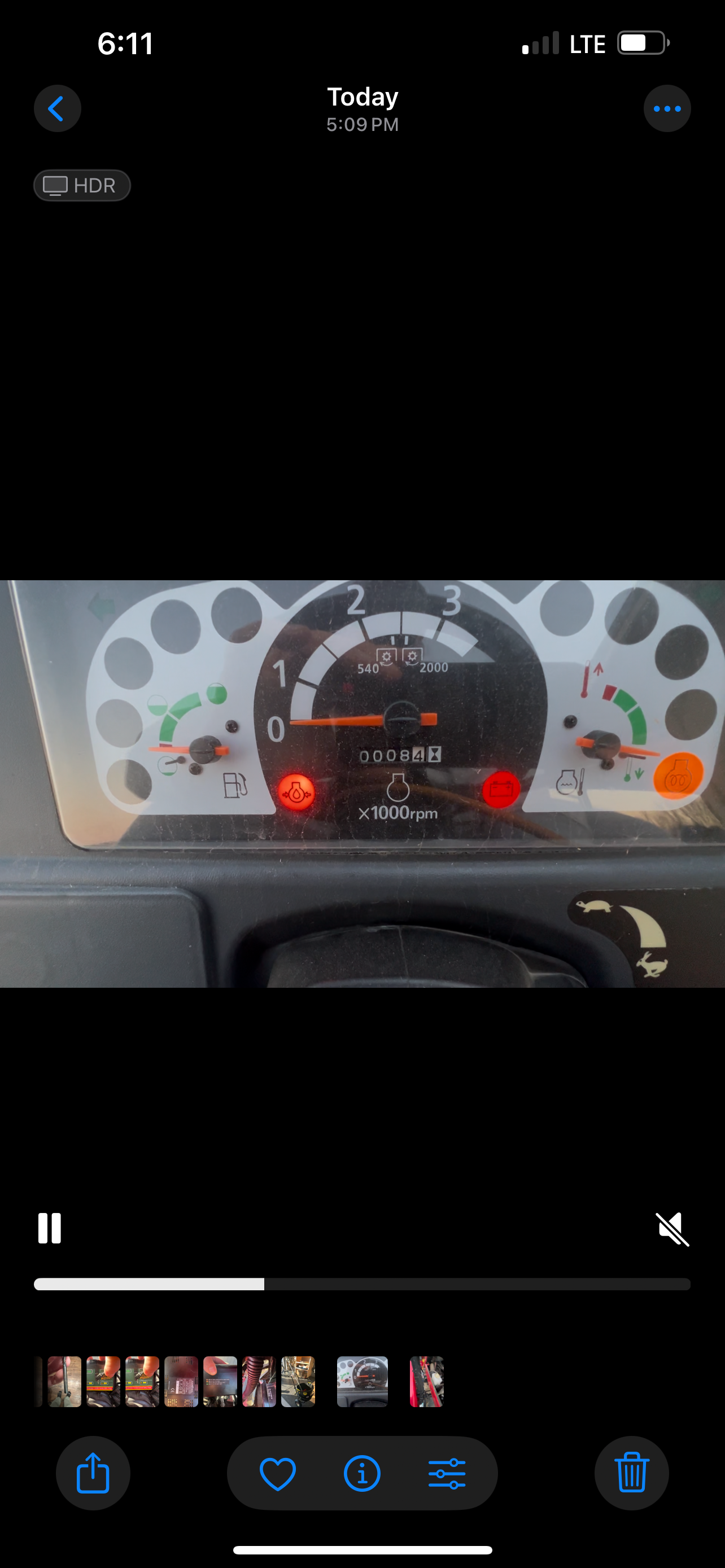

Hello all new to the tractor world. Got a 1626 over the summer it has about 8 hours on it. I must have hit the lights with my knee and killed the battery.
I put it on a tender for 28 hours and the tender shows green.

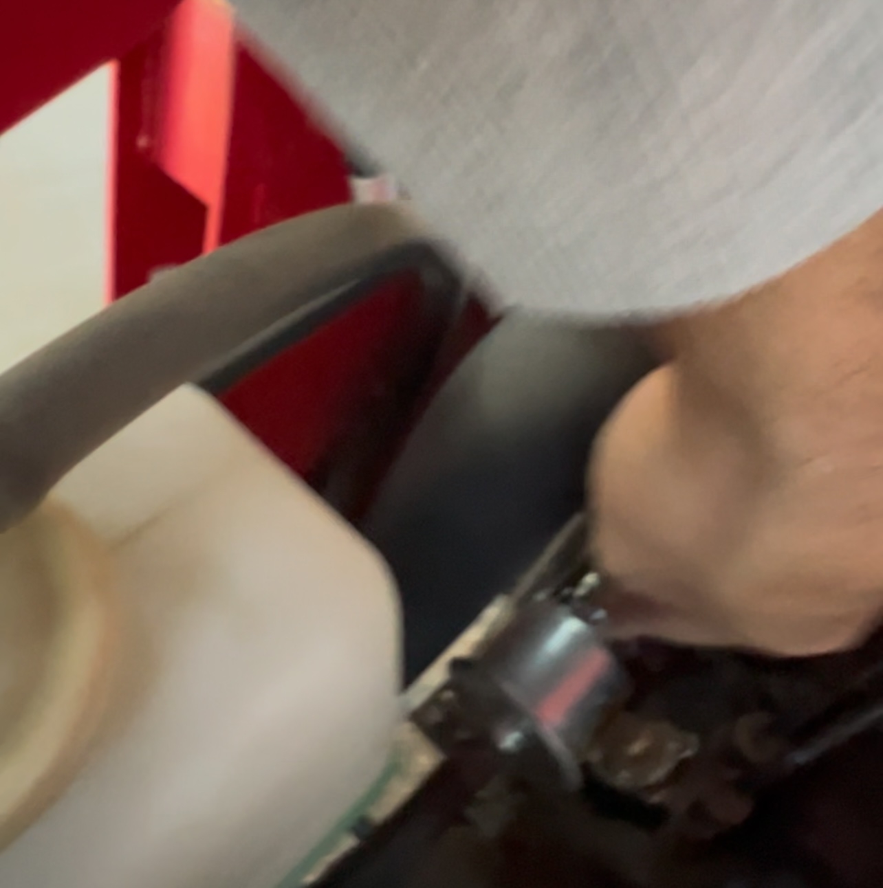

It won’t turn over. Just a clicking sound when the key is on. It doesn’t even try. I took screenshots from a video I took. One shows the dash lights that come on.
The other one shows where the clicking sound comes from when they key is on.
Next step I guess is to buy a new battery. Any ideas would be appreciated

Some batteries will never recharge if totally dead. Put a tester on it while trying to start and see if voltage drops off drastically.
   / Clicking sound won’t start #3
I would check connections… especially ground and then attempt to jump start.
Maintainers work as long as there is something to work with.
At the dealership standard practice was to charge on a 30 amp charger and then load test… some would read proper voltage but the needle fell with load applied.
   / Clicking sound won’t start #4
A maintainer may show green after a mere 28 hours because the voltage is up, but it's unlikely that that battery is actually charged.
With such low amperage it may take weeks to charge the battery. If it even truly accepts a charge after being drawn down that much.
A load test, or using the method mentioned above, will tell a lot about the battery's wellbeing, or lack thereof.

Whenever I get the “click” its almost always my starter solenoid. A couple light taps with a hammer or large wrench and it starts right up.
