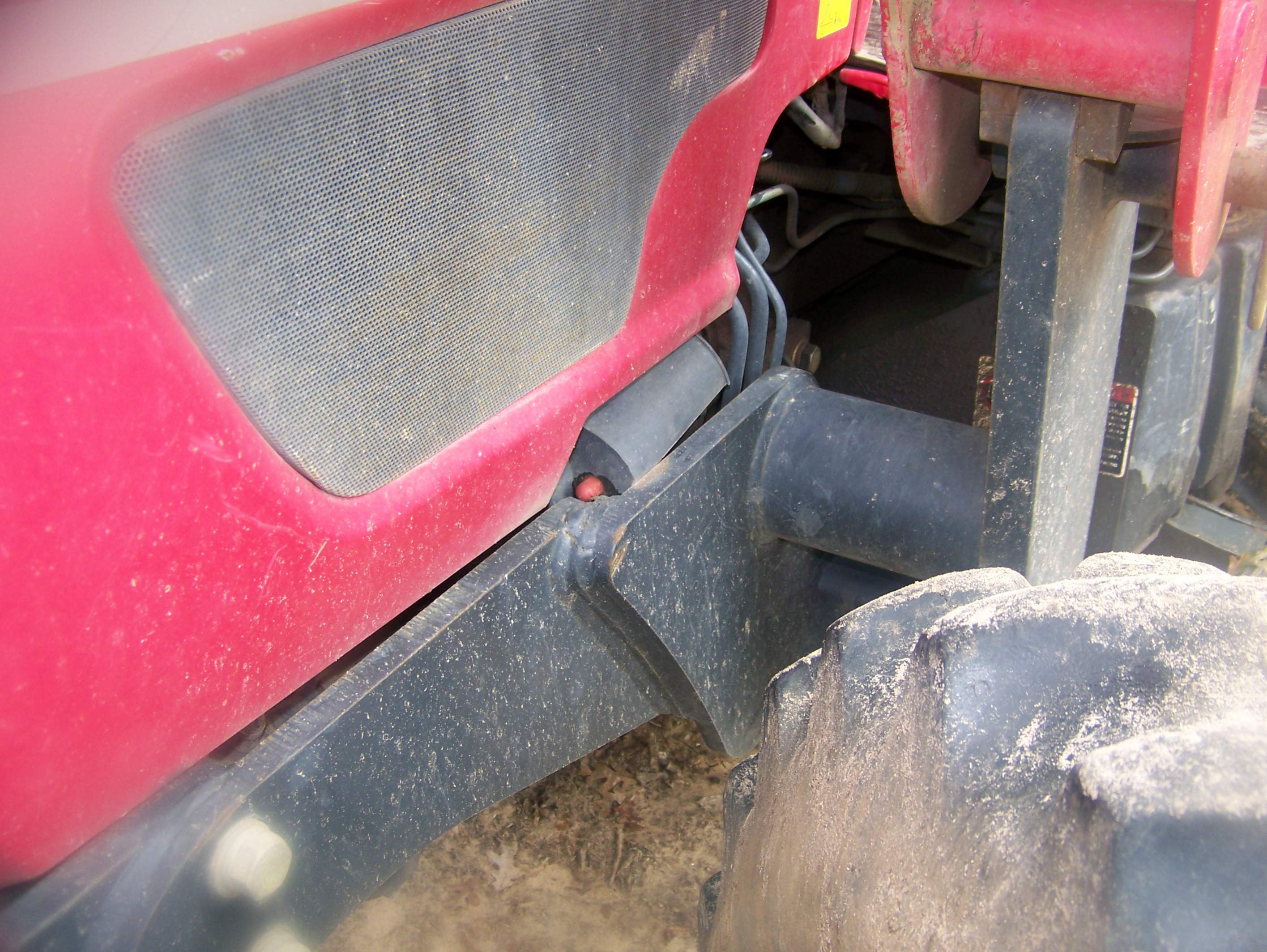

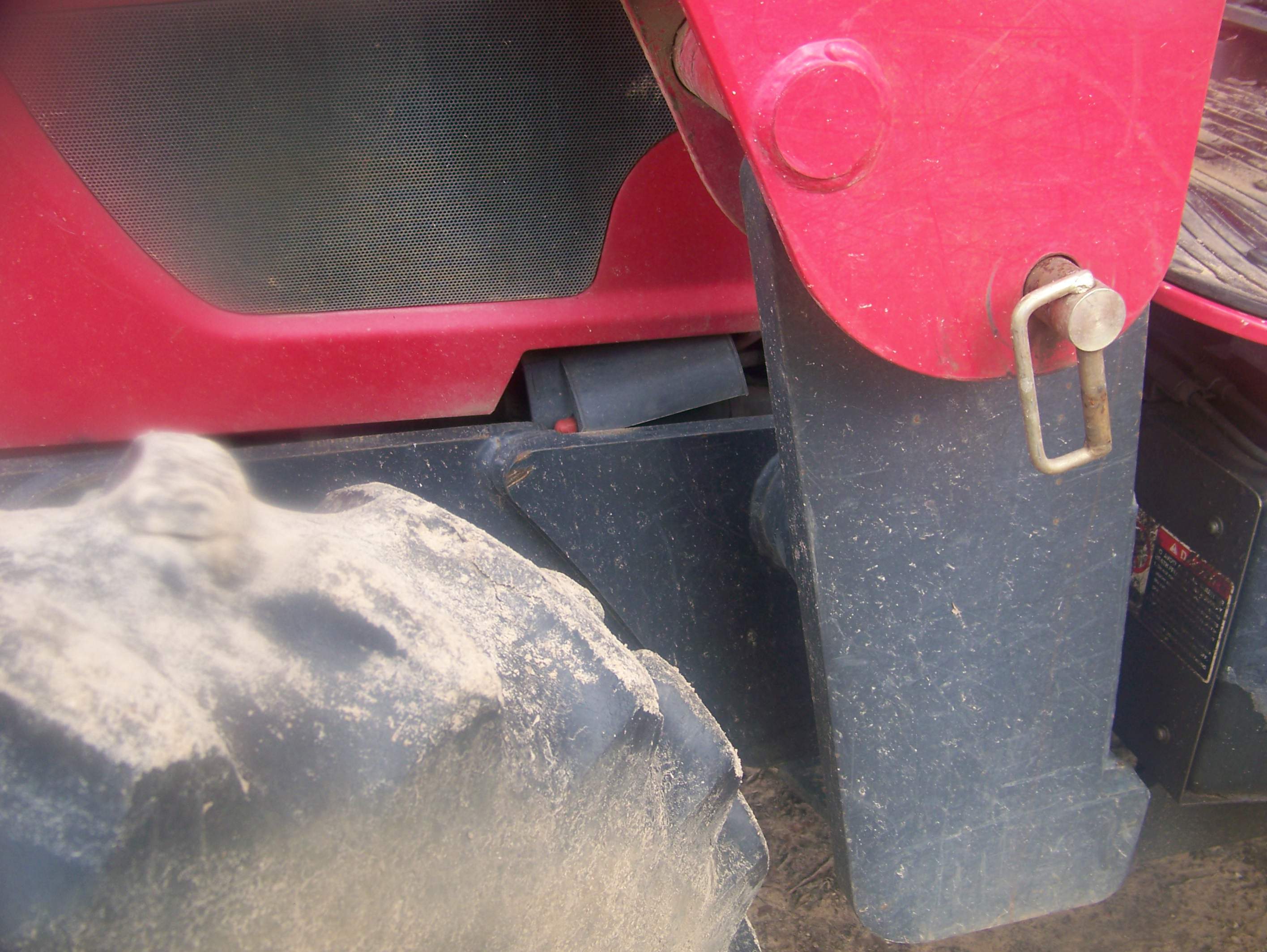

I took my starter off my 4110 Sunday, took about two minutes. The solenoid attaches with two screws that are easier accessed with the starter off. Replaced the solenoid and starter is good as new.
Keith,
Is your starter installation tight like this.......... Big RED Beast Starter Installation 2.jpgBig RED Beast Starter Installation 1.jpg
hugs, Brandi

It is pretty tight with the loader on. My side panels come off easy, and I used a couple of extensions on my ratchet to give me space. I definitely had to remove the starter to change the solenoid.
Bummer,
Hopefully I won't have to do that.
hugs, Brandi
