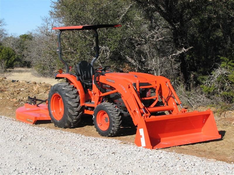

I'm new to tractor usage, and I need to make a road onto our new property. We have very rocky soil, and I am wanting to know the best way to scrape some of the top off to fill in later with crushed rock or something for the actual road material. I can't really get a good bite with the FEL because of the rocks, and I don't want to go too much deeper and take a chance on bending either the FEL frame or bucket. Can I use a box blade lifted up off the ground with only the scarifiers digging in to break up the soil and then come back later with the FEL and scoop it up, or should I put a tooth bar on the FEL and try to rip up and scoop the soil/rocks at the same time, or should I just hire a bulldozer to come in and not worry about it and just use my tractor to clean up the bulldozer mess?
jbrumberg said:
Let the bulldozer at it first. It will be a lot quicker and it will save a lot of wear and tear on your tractor. Jay
You can see the kind of soil if you look on the other side of the rotary cutter. The rocks are not very big, but there are many of them.

Texas John:
I put a picture of my new tractor :)D) along with some of the rock that a bulldozer had turned up right next to it in the thread so you can see what it looks like.
BTW, I'm up in the North Texas area. I think our rock is called shale around here, although I always thought shale was the kind of black or gray coal-like brittle rock sheets like you see up in the Appalachian mountains.
Jerry in Texas
