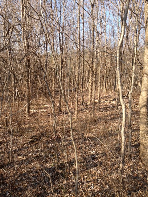

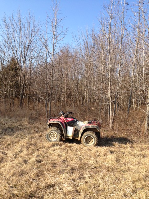

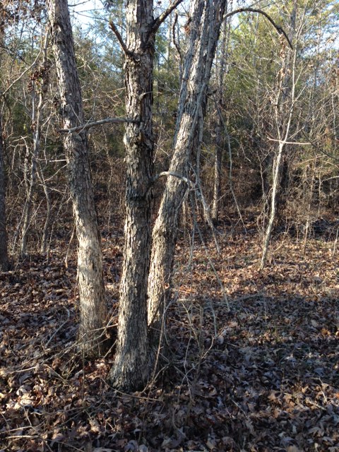

Hello,
I need some advice on clearing some cutover. The cost will require that we do the work ourself. My initial thought was to buy a dozer and sell when the work was complete. Last night while doing some research I ran across the forestry mulchers. Now I am wondering if this might be a better option.
The Cutover was cut about 20 years ago. There are several different tracts totaling about 150 acres. There are some trees 6 inch in diameter but it is mostly smaller. It is very thick in spots. The ground is mainly flat to rolling. There is a creek but the land should not be too wet in summer. Rocks above ground are minimal and should not be a problem. However, if we go the bulldozer route there are a lot of rocks once you start breaking ground.
The end use of the land will be to restore to pasture. Most of this land is already fenced in and cattle have access to it.
I understand that this will be a long process but I am not on a deadline with this. My plans were to possibly buy another farm within the next 2-3 years. We are currently renting a second farm. If we can convert this to pasture we wouldn't need the additional acreage and increase the value of this farm as well.

If you're going to make it into pasture I believe mulching is a viable option. I know that a lot of people will say that 150 acres is too much for a skid steer size mulcher, but I don't see much difference in doing 150 acres in one project or doing 30 5 acre projects. A bigger machine will be much quicker, and easier on you though.
My "go to" machine for mulching is a Fecon FTX-90, which is pretty small by some standards. I like the Fecon though.
If you decide to go this route, choose a machine with low hours, and don't expect to get your money back when you sell it. You're going to put a lot of hours on one doing 150 acres, and the higher the hours, the cheaper the machine.
From the pictures you posted, it looks like just about the right size to be a nice mulching project. Is everything as flat as what's in the pictures?

I'd vote to mulch it. A lot of farmers face the same dilemma here in Texas. Doze or mulch. You mentioned subsurface rocks. You will pull them up with a dozer for sure. I'm sure even your small trees are deep-rooted in Virginia. A mulcher will leave stumps. Lots of them above and below ground. The deciduous trees may grow back. Some won't if they are mulched fine enough but you will be able to maintain the property with a batwing or other rotary. Over time, the benefits of having shredded material breakdown and add nutrients to the soil point even more to the mulching operation.
150 acres, spread out, isn't too much for a skid steer mulcher which would be, by far, less maintenance and cost to repair than a dedicated machine plus you get the added benefits of a swiss army knife machine.

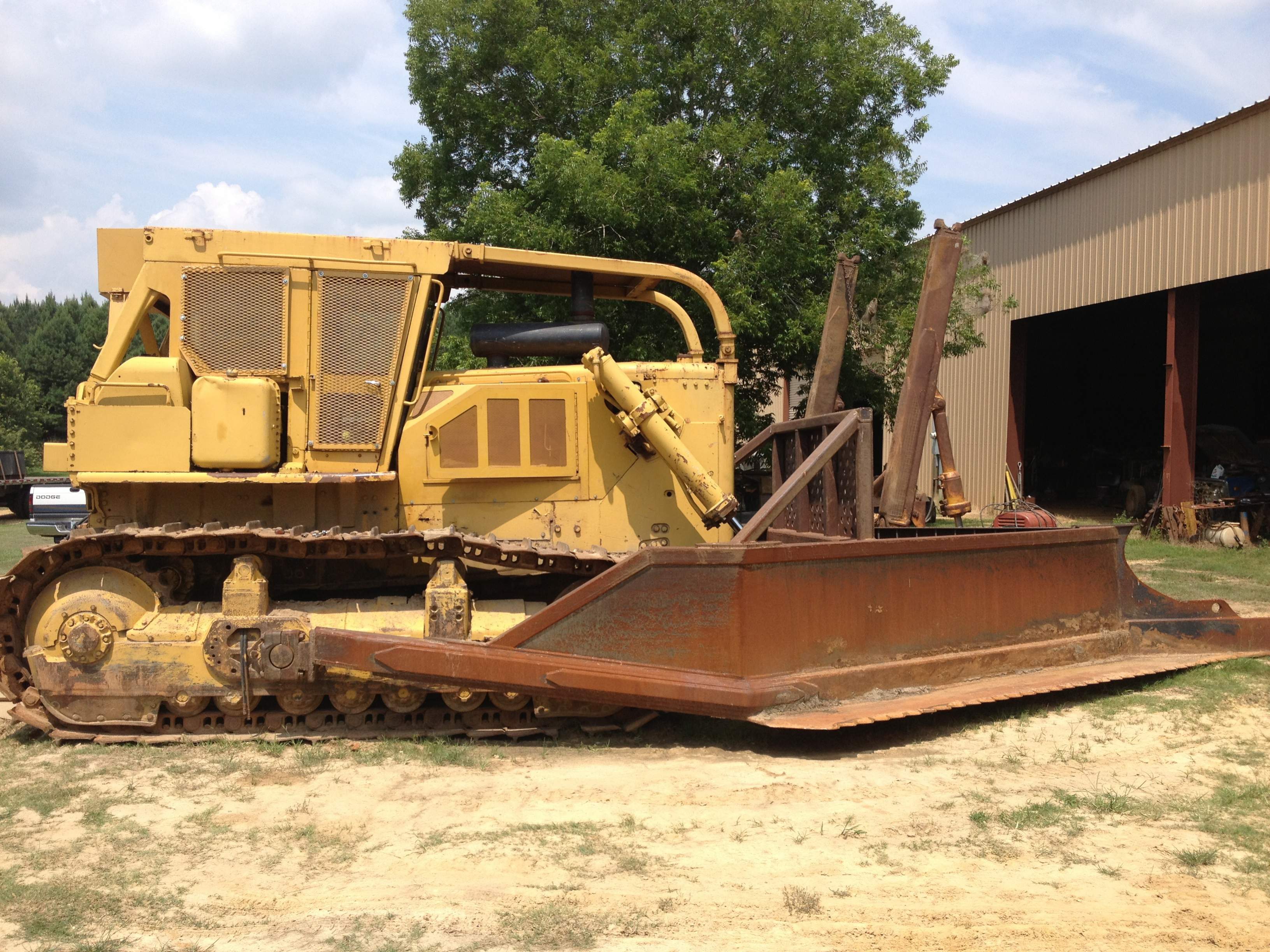

Go buy a D8K and I'll sell you my V blade and you'll have that done In no time, mulching would be good but could cost 5x as much if you buy your own machine, shear it rake it and burn it, run over the rest with a new earth plow and that will be as good as you'll get, cows don't care about stump holes trust me
This costs less than any mulcher
