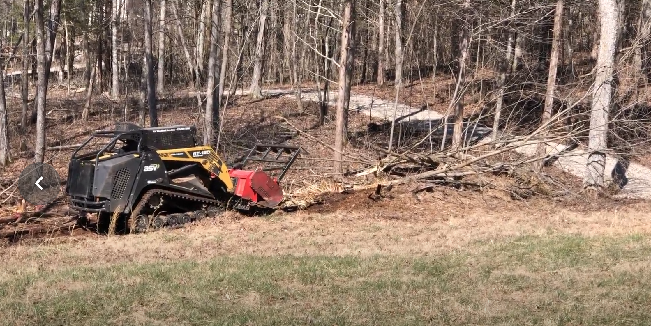

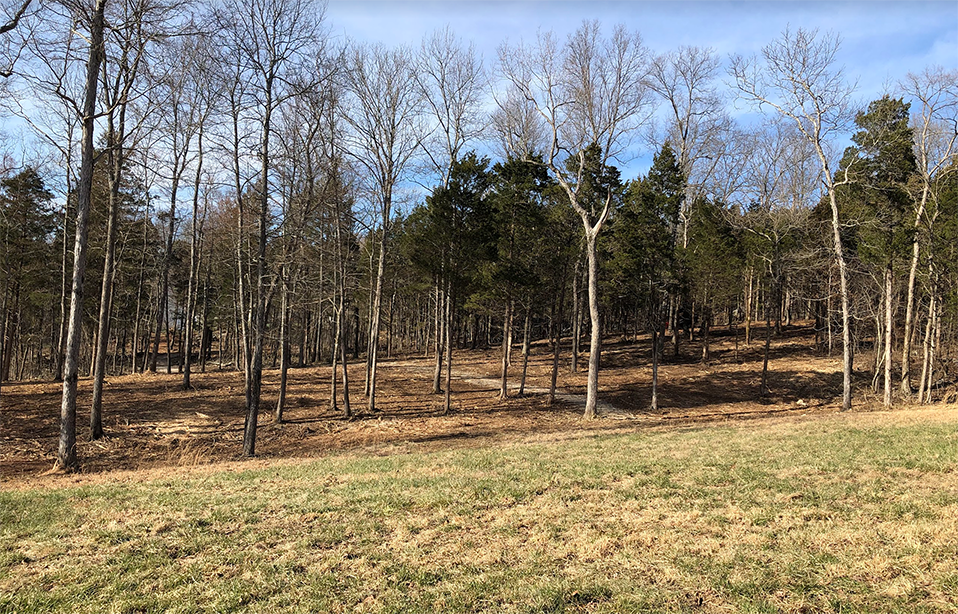

Yes, a few hundred per hour with a minimum and travel time. It's going to take more than 3-4 hours unless it's really small stuff.
