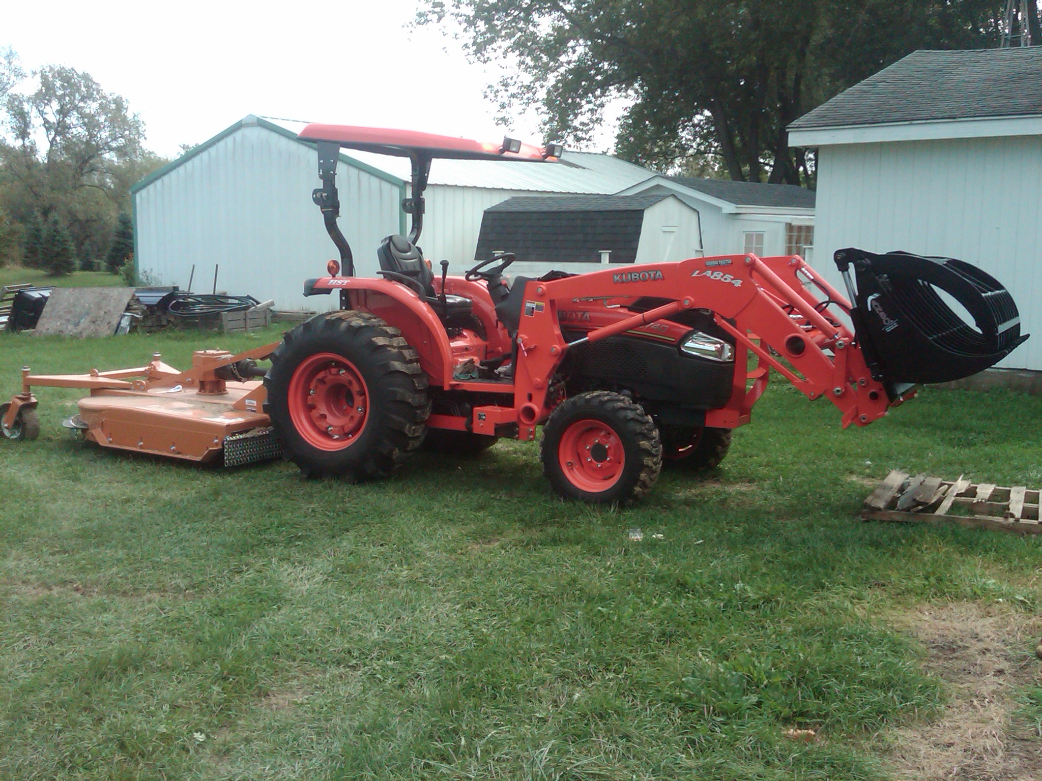

Use a grapple!!!!
I didn't even know what a grapple was 2 months ago:confused2: Go and rent one on any machine and you'll find out why guys are in love with them. I've been digging out willow stumps 18"+, scrub hawthorn, maple etc... 4 inch trees don't even complain against a grapple. If you get tough roots...you simply use the grapple to unroot one side then switch to the other side then go for the middle. Done.
You can clear trees, rocks, you name it and build the biggest pile in the shortest amount of time.
Had I known about this device or had anyone recommended it years ago...I'd be a new man today!
