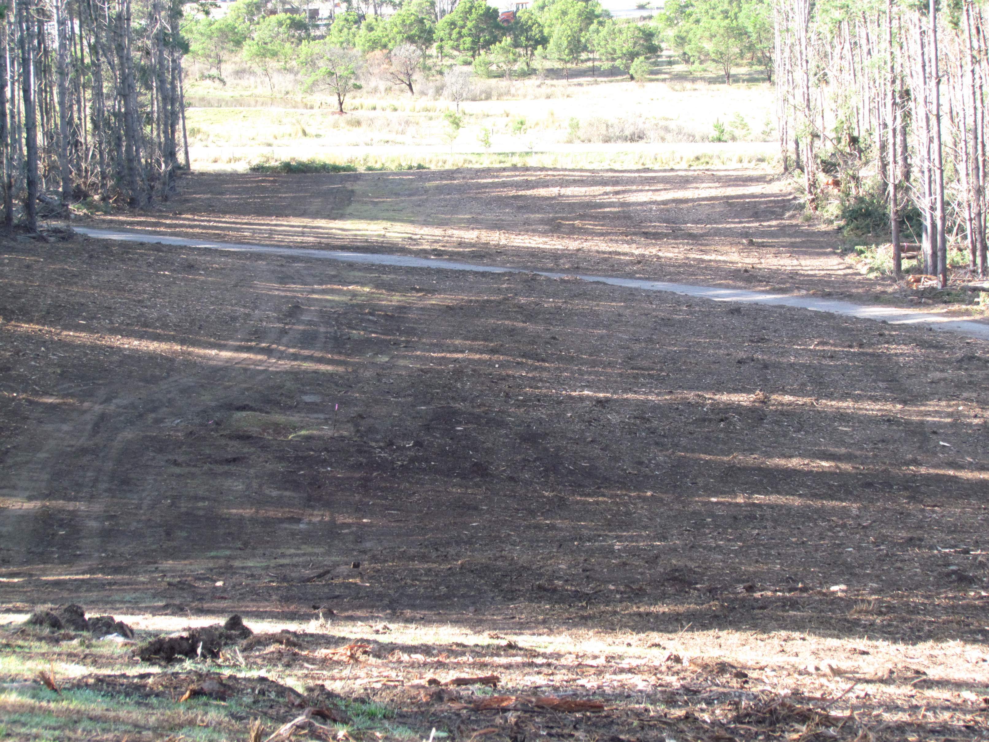

You could grind those stumps pretty quick. Maybe rent a Bobcat with a stump grinder. I could do 100 in a few days if you just had to get them below grade. Might even go faster. Getting to them while they are still fairly green will make it go quicker if you grind them.
Unless you have to dig them out for a particular reason, I wouldn't go that route and create a bigger problem to deal with.
PLUS 1. The mess of digging stumps out verses grinding is huge and rehabilitation costs are factored in is digging stumps worth it? Just because a job has "always been done like that don't make it right". 100 stumps cut close to the ground is only a few hours work for a reasonable sized grinder. Stumps that size is only about an hours for my C140. One job I did I ground 1000 stumps in 10 hrs. Try doing that with a excavator, dozer or any dam thing with a bucket or blade and my job was a finished job:2cents: IMG_0453.jpg
