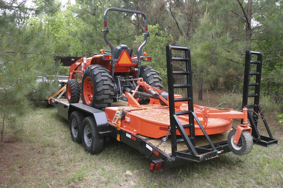

I just purchased a Kubota Grand L 5240 and bush hog. I have about 16 hours. I am in a field with weeds about 4-5' high. I thought that I would not get much seed in the radiator and oil cooler. I was running the fel low so the bucket would knock down some of the weeds. After 3 hours there was considerable debris on the radiator screen. The only way to clean it was to raise the fel, pop the hood and remove the side panel to get the metal screen out. I thought JD 4000 series was whimpy because of the plastic screen but in retrospect probably a good idea. Anyway I used a compressor and blew out the seeds. The whole process took some time and I had to work around a raised fel.
This last trip I had my stihl leaf blower and started blowing off the grass off the tractor. I popped the hood and blew out the weed seed in about 30 seconds. I never had to touch the screen and got dust out of all kinds of places that I would have never gotten out with my compressor. From now on, where ever the tractor goes, so goes the leaf blower!
So the leaf blower is much faster, much safer if you have a fel and have to raise it to take off the side panels. It gets ride of all of the crap all over the tractor, bush hog, trailer in about a minute!!

Nice setup. I'll keep the blower idea in mind. Pretty smart. What size trailer is that? 18 or 20 foot?
