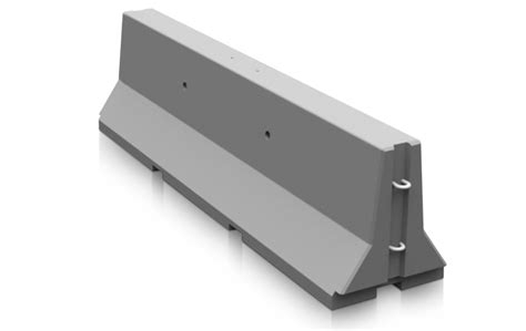

🤣Thanks Bruce! :ROFLMAO:
That is "Plan K". It would be closer to "Plan B", if it didn't add so much additional pressure to the down slope retaining walls. At least with a concrete retaining wall, it has some longitudinal strength and rigidity.
This being California, on a slope, on clay soil, I think of everything, soil, trees, roads, etc., as being in slow motion downhill, not necessarily restrainable long term. Even the county road, which I am sure was better built than my driveway, is practically graffitied with tar strips patching cracks from road slippage and movement.
