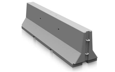

   / Cleaning out and reusing some old concrete fence post foundations? #9
Bruce
