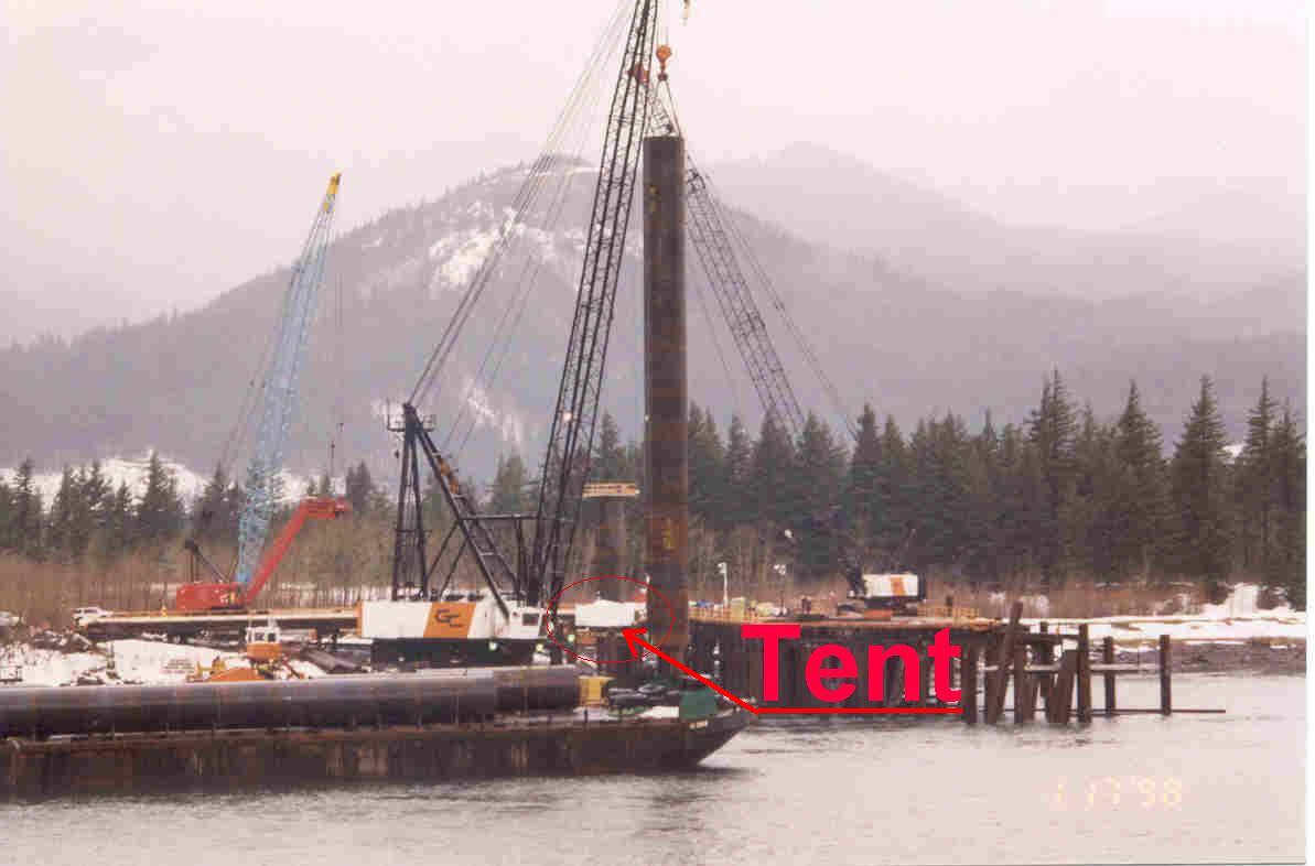

I was the project superintendent on that project, so I didn't do any welding. I did elect to go with dual shield for the splices on the 10-feet dia pipes. The work trussle that the crawler cranes are setting on was built with 36-inch dia pipe pile with 36 x 300# I-beams for cap beams, all of this welding was done with Innershield wire. That trussle is roughly the size of a foot ball field.
You can see where we had a tent for the weldors in this picture. I think we had two weldors inside, and four weldors welding on the out side. We did use ceramic backing strips for the root passes. All the welding for the 10-feet dia pipes was 100% X-ray.
Using a robotic welder never even crossed my mind, not even to this day, until I read your question. Generally the owner, (in this case the Army Corp) never tells the contractor how to do things. Sometimes you have to submit a operation plan for their approval, but I don't remember having to do this.

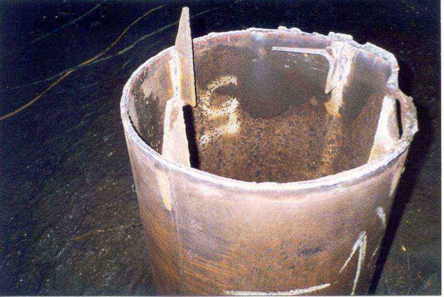

We had a very hard time getting weldors there. When we started building the trussle, I was out in the river over seeing the rig up of the derrick to start driving the water piling. Very good friend of mine was over seeing the land pile driving. He called me on the radio, and asked if I could come to the beach and help one of the certified weldors set his machine. This kid was about as screwed up as it gets:rolleyes:. The pile driver was always waiting on the weldors because they couldn't splice the piles fast enough. I went in and took one look at this kids weld, and went oh my God:eek:! I set his machine. I went over to my buddy and asked how hard the pile were driving. He said they were going right down. I said get that splice in the ground as fast as you can, because the weld is horrible! Right there was one of the biggest mistakes of my life:eek:. I went back out to the derrick. This kid finished welding the splice, my buddy swung the pile driver over and got back on this pile. The second blow of the hammer I knew we were in trouble! The weld broke:eek:! The pile fell over like a big tree that had just been cut! Some one had parked my company pickup too close to the pile diver. Long story short, the hammer came out of the pile driving leads and landed on the hood of my company pickup:eek:! I wish I had a picture of that truck. The hammer weighed about 10-tons, drove the engine right in the mud!
I do have a picture of the broken pile.
