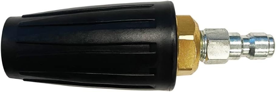

Due to various plantings around the house, I'm afraid to use chemicals. Instead, I use this Turbo nozzle with my pressure washer:
I use plain cold water, and it does a great job.
/ Cleaning Mildew From Vinyl Siding? #32
Just don't get too close. I've accidentally etched things with that nozzle, though I love it for tough jobs.
