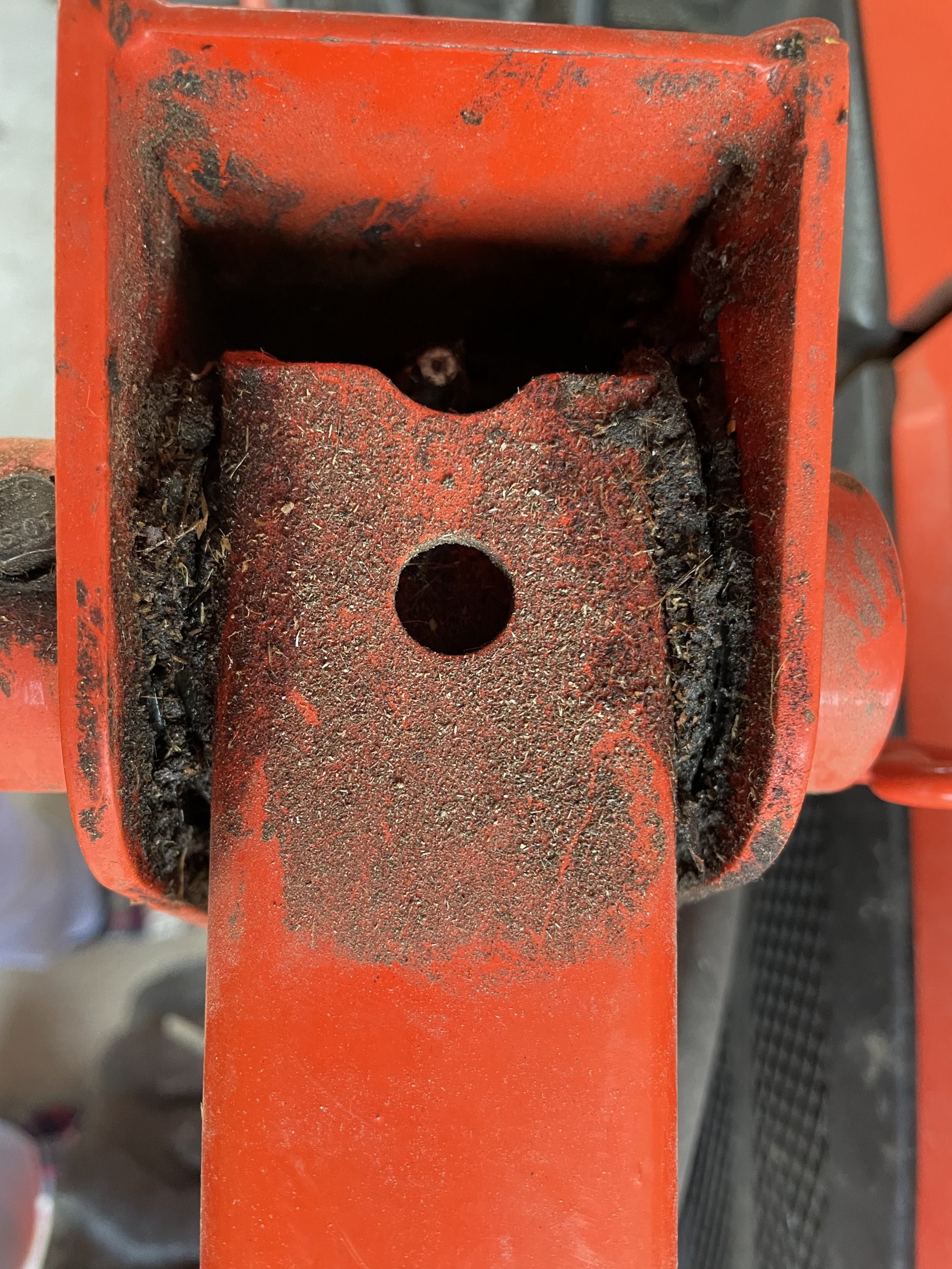

I know that lots of grease on my front loader arms is a good thing (it's being lubed), and many (most) people don't worry about it, I'm getting tired of what seems like the tendency for grease to jump onto my clothes (like porcupines shooting their quills - which they don't).
When it warms up a bit I'm thinking of taking some time to clean the built up grease from the outer painted areas around the arm's grease fittings. I'm NOT worried about the inner areas - just the surface on the outer perimeter.
What would be a good, efficient, safe cleaner - that would dissolve the grease? Mineral spirits on paper towels? Detergent & warm water? I certainly don't want to thin out the grease in the bearings. I don't want to damage the paint.
Resist the temptation to clean it off. All that grease keeps sand, dirt and rain out of the bearing surface.

Spray what ever you are going to use on a
rag then wipe off the grease should not get
in the joints etc
