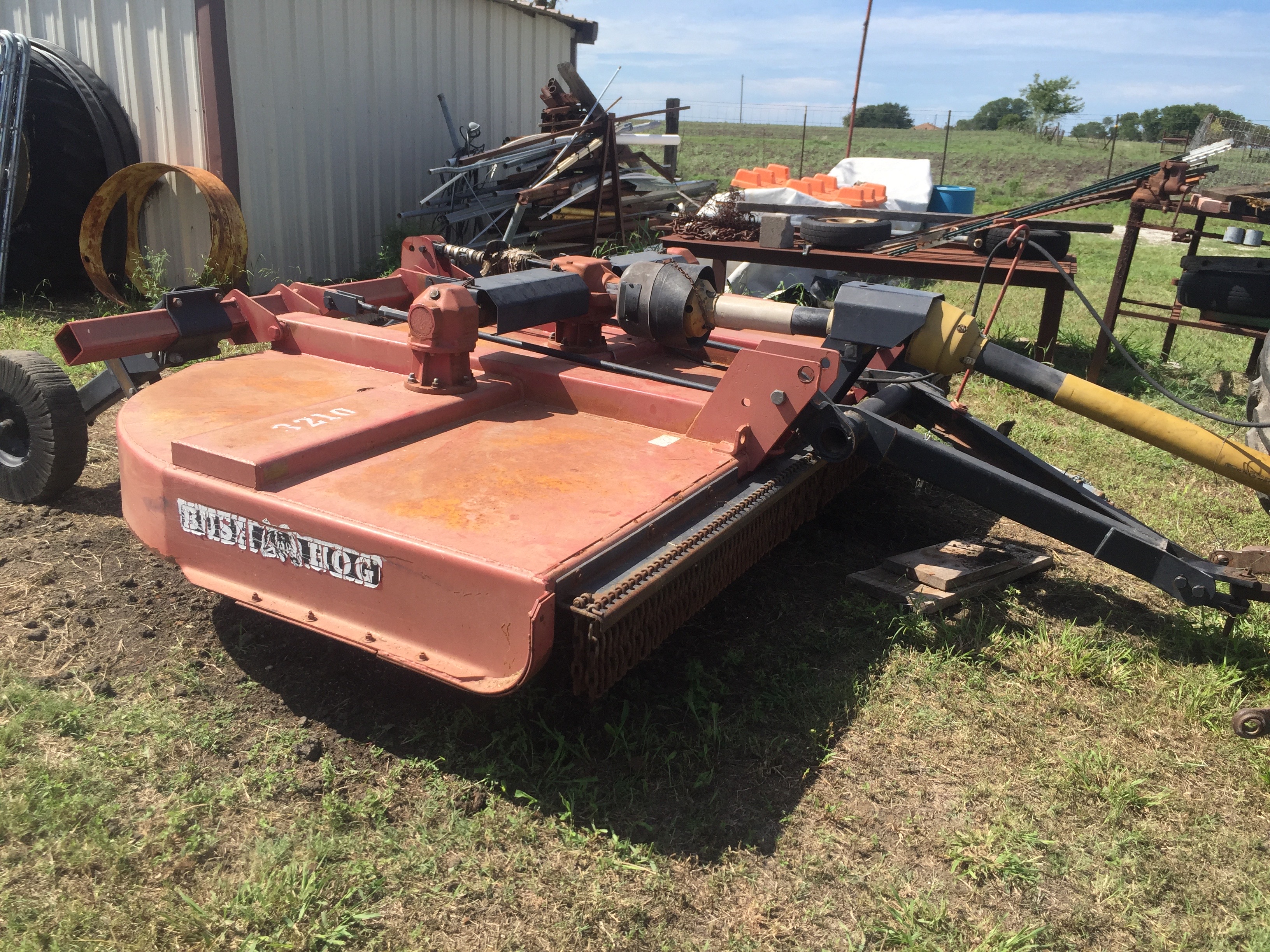

Cleaned up and re-painted ol Bushhog....

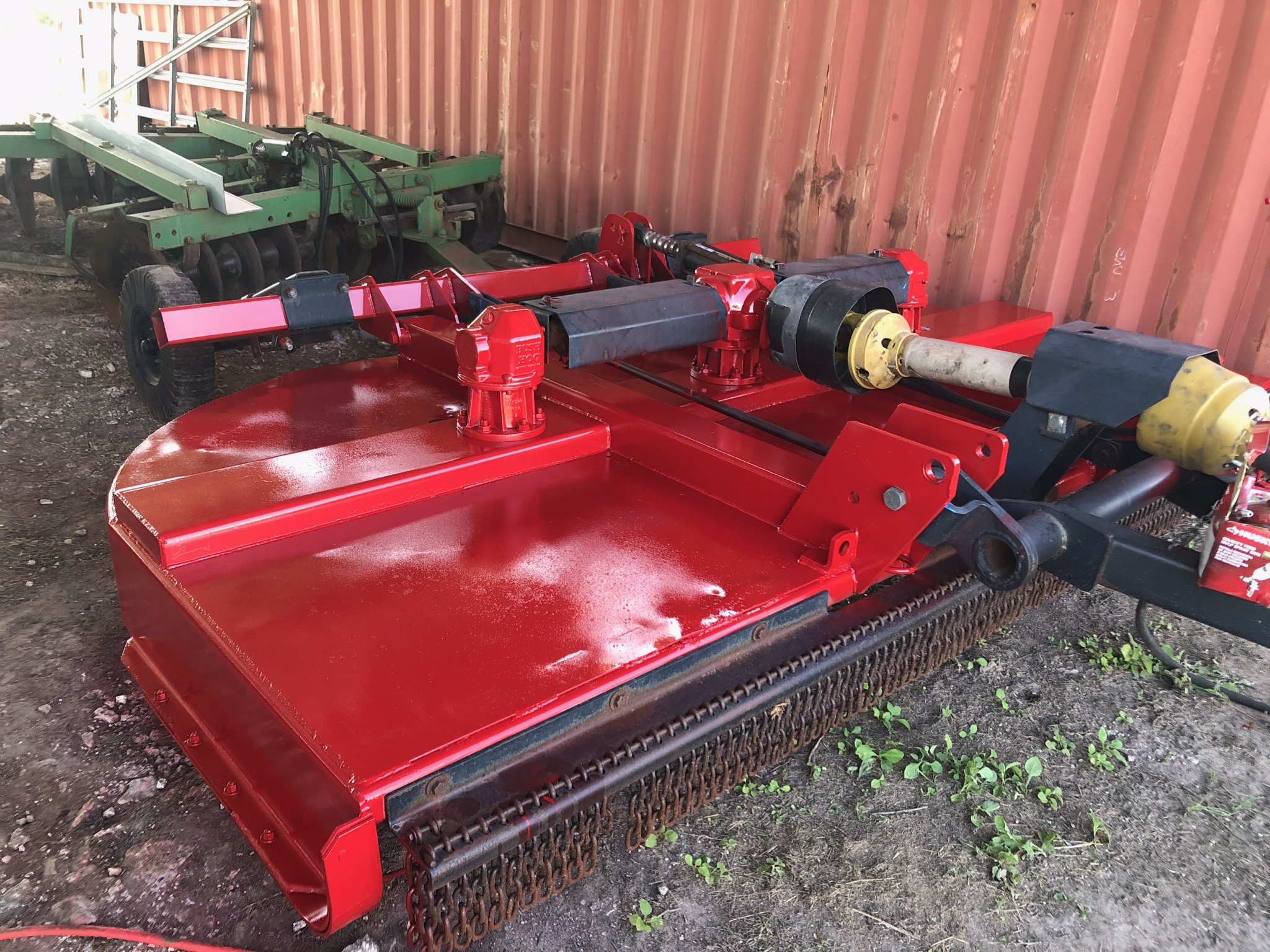

Yep , looks good ! Nothing like chain guard on them also instead of the rubber cheaper rock guard . IMO .
   / Cleaned up and re-painted ol Bushhog.... #12
Tractor Supply enamel.. I’m not 100% but I think it was IH Red.. (read somewhere it was a close match too Bush hog)
No hardener.. Im a novice.. Just a little thinner with the paint ran thru a cheap gravity fed paint gun..(home depot $50)
What does the hardener get you?
Mixed in exact proportions, to the right paint, it helps it dry faster and is a bit harder when dry. Only use it when mfg's state how to use it.
#13

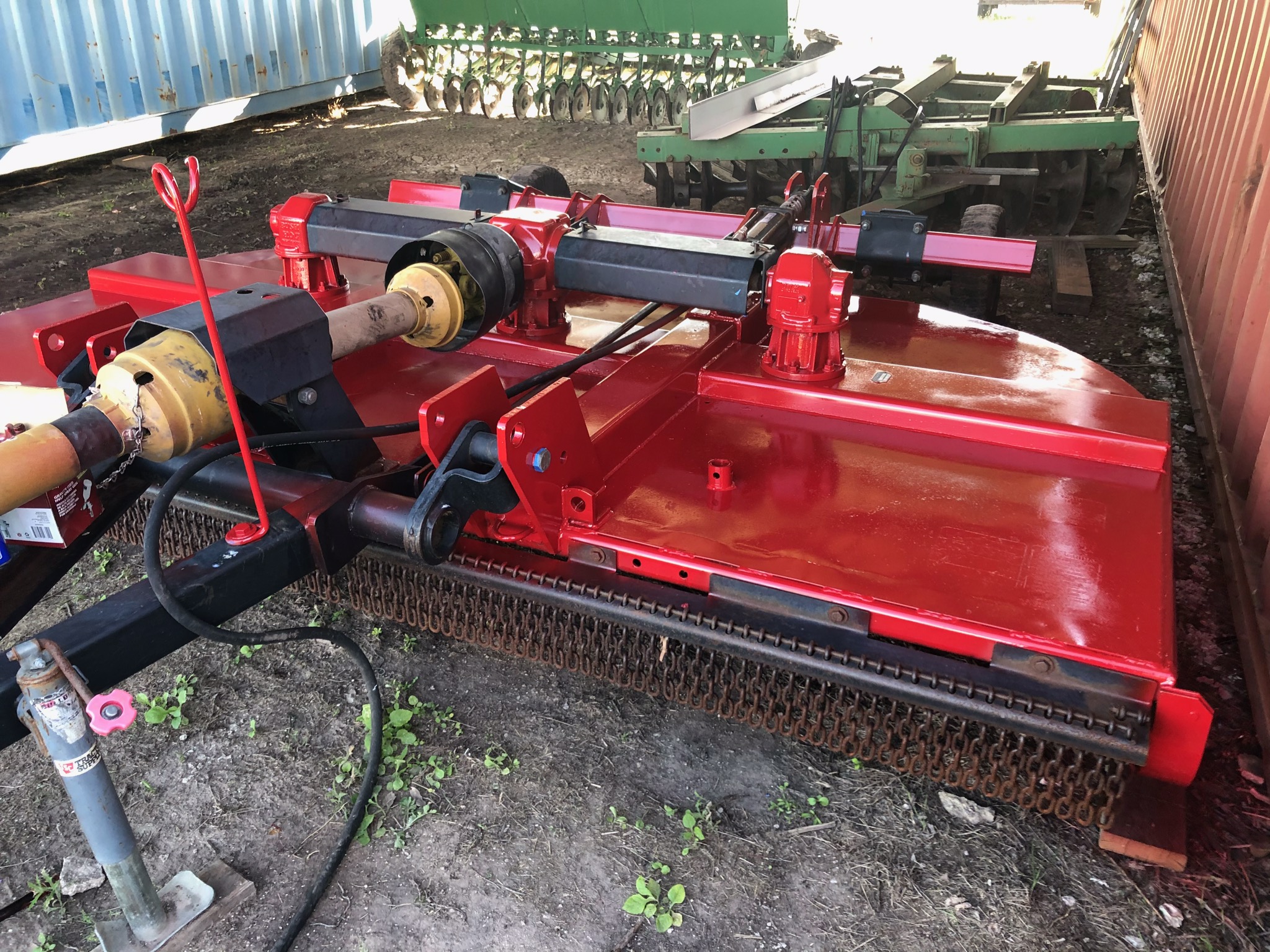

Yes.. My Deere 709 had rubber belting and I would always pucker when I heard sticks/rocks hitting the back of tractor, just thinking my glass was about to shatter. With chain, I don’t hear anything hitting the back of the tractor anymore.. Another thing Mfg’s should be forced to install for safety...
#14
Sounds a bit too precise for me.. I’ll have to research it more next time..
