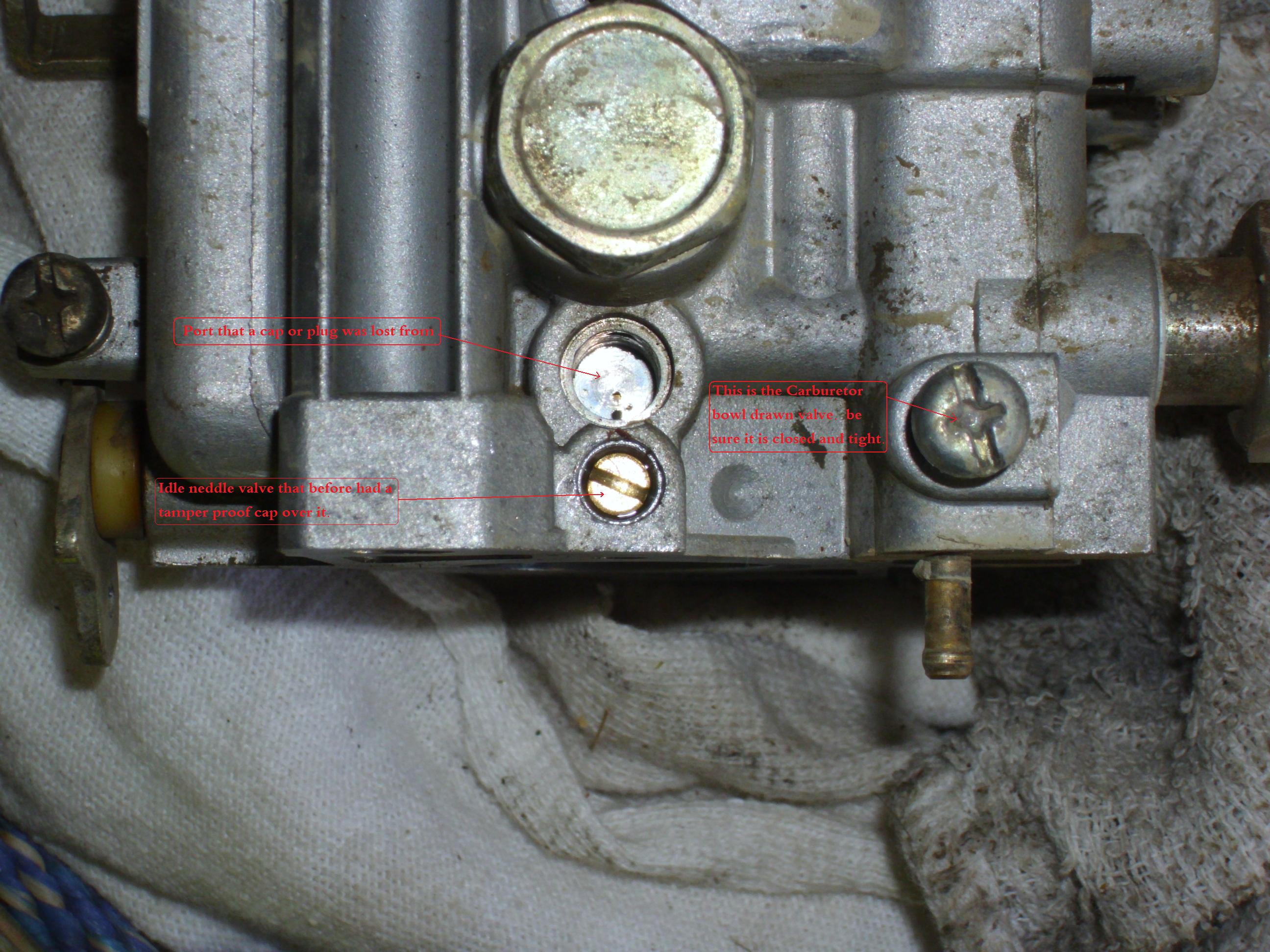

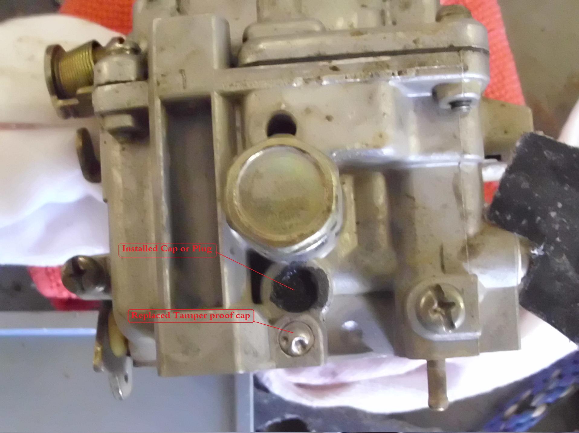

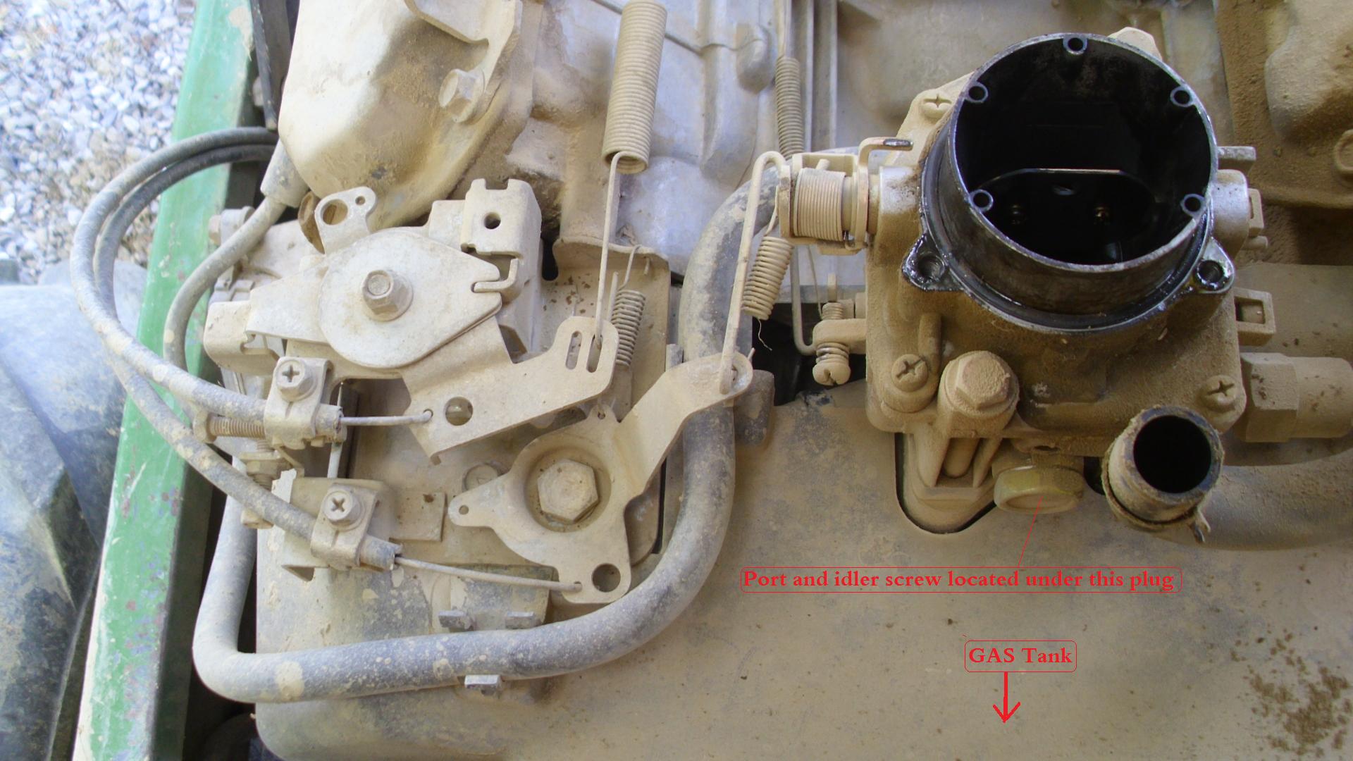

My PT 422 2003 model Robin engine started loping. Pretty bad this time. Any way to make a long story short I found that a plug or cap must had fallen or come out. I had cleaned and took apart and blew out but nothing helped. And then I noticed a port that look cleaner than it should be especially when it was below and outside the air filter. With the engine running and it loping as it was I reached in and put my finger over that exposed port. Low and behold the engine smoothed out and ran like new. Here are some pics to help explain.

/ Clean up that carb #20
Why replace the tamper cap? Now you cannot adjust it. I did not know of this cap when I cleaned mine. I guess I missed something.
