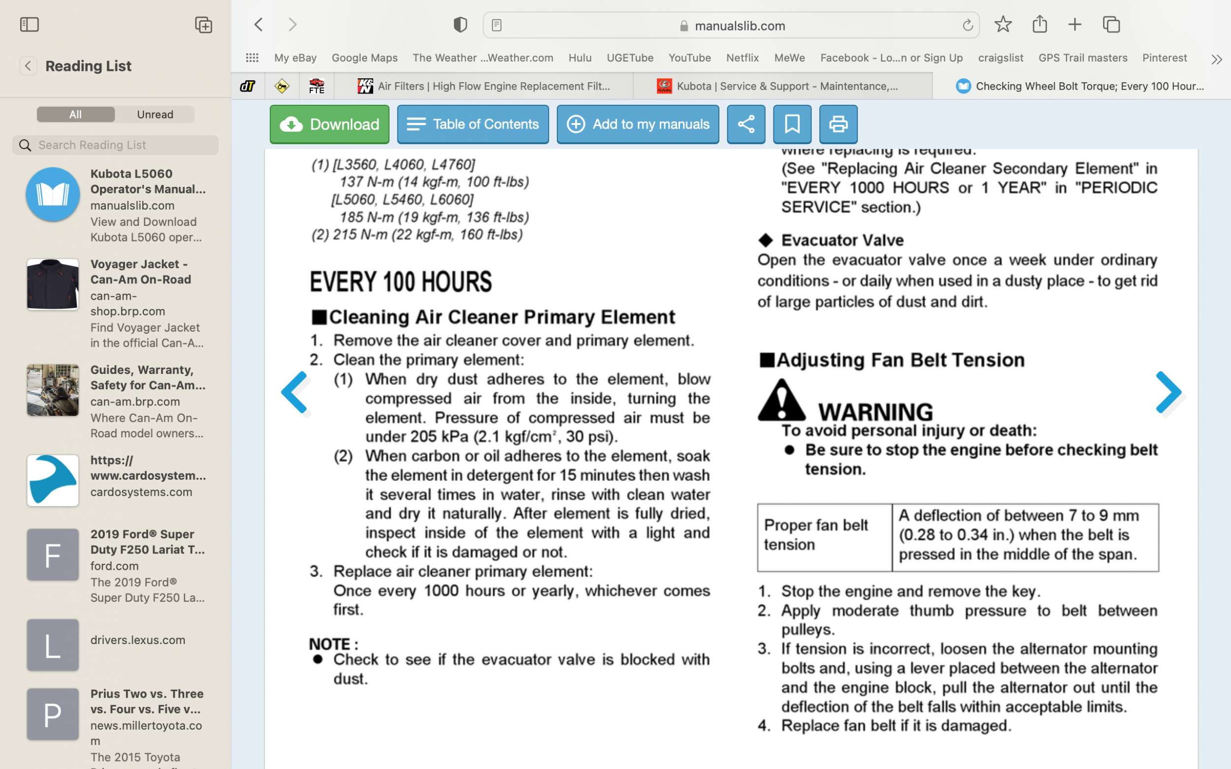

I clean mine with compressed air from inside out. Not had a problem with the pressure. In the field when bush hogging , I use my husqvarna handheld blower that I use for radiator and rest of tractor.
I have used my shop vac on outside of filter as well.
/ clean air filter #26
I have an inner and outer air filter. I'll remove the outer filter and blow it out using about 45psi air and one of these.
About or twice a year, I remove the inner (backup) filter and check it. Its never needed cleaning or replacement. Once it does, the outer and inner get replaced.
The cabin air filters just get blown off and re-installed.

/ clean air filter #29
Ok guys, I searched and didn't find anything, quickly. How does everyone clean the air filter on their tractor. I know blowing air into it will sometimes pack the dirt in tighter. Is there an air filter cleaning solution that works? Just soap and water? Spray with degreaser and wash out then let it dry? If they weren't $70+ I wouldn't try cleaning it. I've seen a lot of cheep air filters on line, but don't really want to take a chance on letting dirt destroy my engine because the filter didn't do it's job.
Many years ago a guy who ran a garage for years said always blow dirt from inside filter out, otherwise it packs dirt in.
