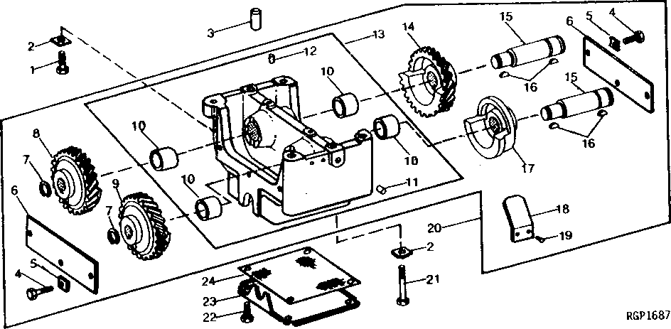

:welcome:
Actually the engine has a counter balance box with several gears & 2 shafts in it.:

The 270 cu in engine is the same one used in ag 3020 row crop tractors. It is a good solid reliable engine. It has wet sleeves, so easily rebuilt. As you mentioned, it has the counter-balancing unit bolted on the bottom of the block in the oil pan. The engine is a smaller version of the six cylinder 404 cu in engine used in many models and horsepower ranges in ag models. Same bore and stroke. Blocks and cylinder heads for the 4 cylinder version are a little scarce since they weren't used in many models.

Thanks txJim, I oversimplified, it's quite the balance box.
