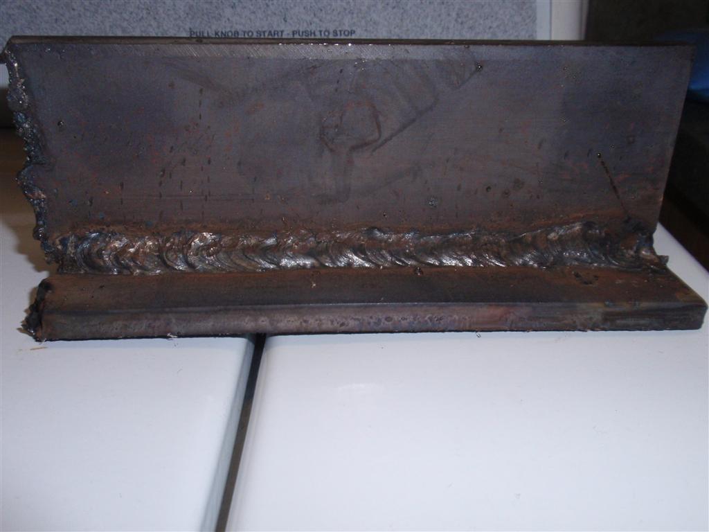

Last night, we started into overhead position. Laps, butts, Tees. Mostly 6010, but then when I was doing fine on all of those, I grabbed some 7018 and did that in overhead too. Looks better in person than in the pic, IMHO... Only one tiny little spot of undercut where I slipped. It was done inverted from how it is pictured (the short leg was upside down). 115A, DC+

Its not bad at all. You must be using 1/8?
I'd slow down the forward travel a little more, not stepping so much forward at one time.

Yep, 1/8". I do tend to step too large, but can't seem to get that tighter for some mental block reason. I'm not rock steady, and that is a lot of where it shows, I think. I was pleased as punch that I had no undercut. That's been what has been killing me the most.

I'm far from an expert welder, but I'll share my experiences with undercut. I usually get it under two conditions, first being that I spend too long on the "turn" at the end of a weave. That allows the arc more time to burn into the base metal. Second is simply too high an amperage setting.
I find if I'm welding two different thickness pieces, I have to spend less time on the thin piece side, otherwise it'll start to undercut.
Nice looking weld by the way :thumbsup:

So you are saying you did that out of position/ overhead? if so I would say it is very good.

Yep - overhead. Basically flip it over from how it is sitting, and that is the orientation it was welded in. That's one of the big things I was looking to get out of class - out of position work, and we've been doing a lot of it.
