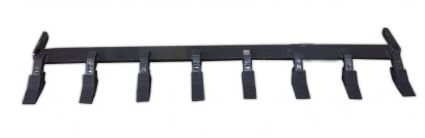

The 'tooth bar' you refer too, is that the same or similar to a 'ratchet rake'?

Toothbar pic attached. Had one on my previous tractor and I liked it. Ratchet rake looks nice too. I'll have to read up on that! Thoughts on it on the rake?

Your rake bolts onto the bucket sides, from what I can tell about it from the pic you posted.
I'd focus all my energy on getting your tractor fixed and then continue with rakes, and other tools.
