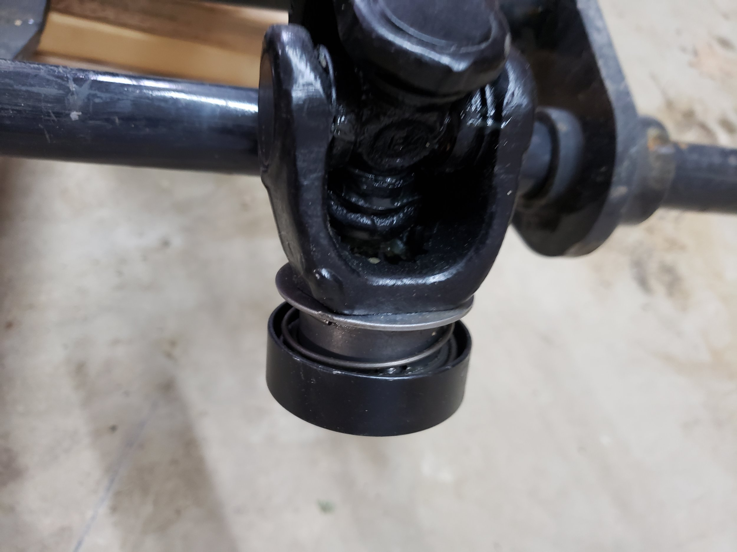

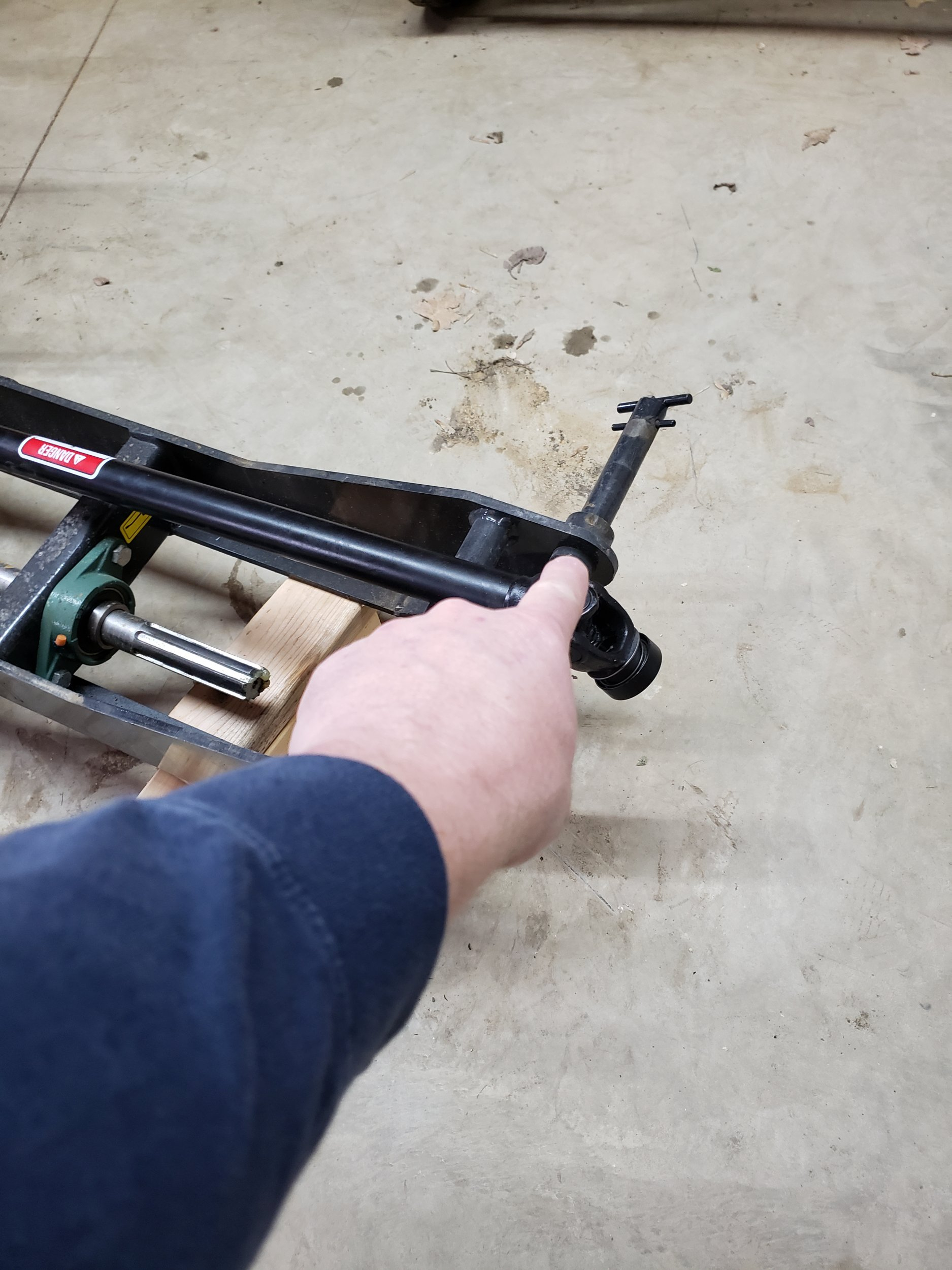

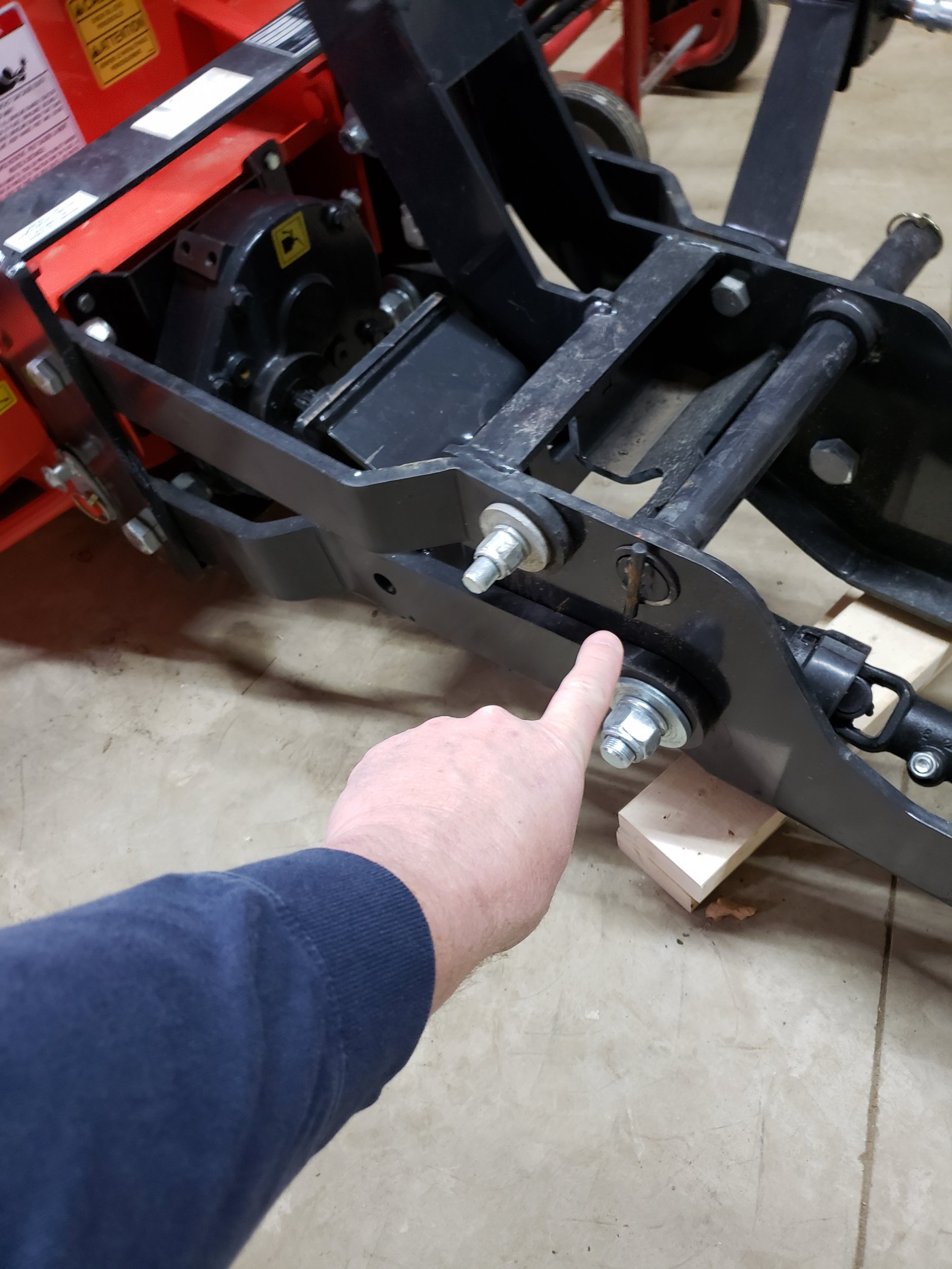

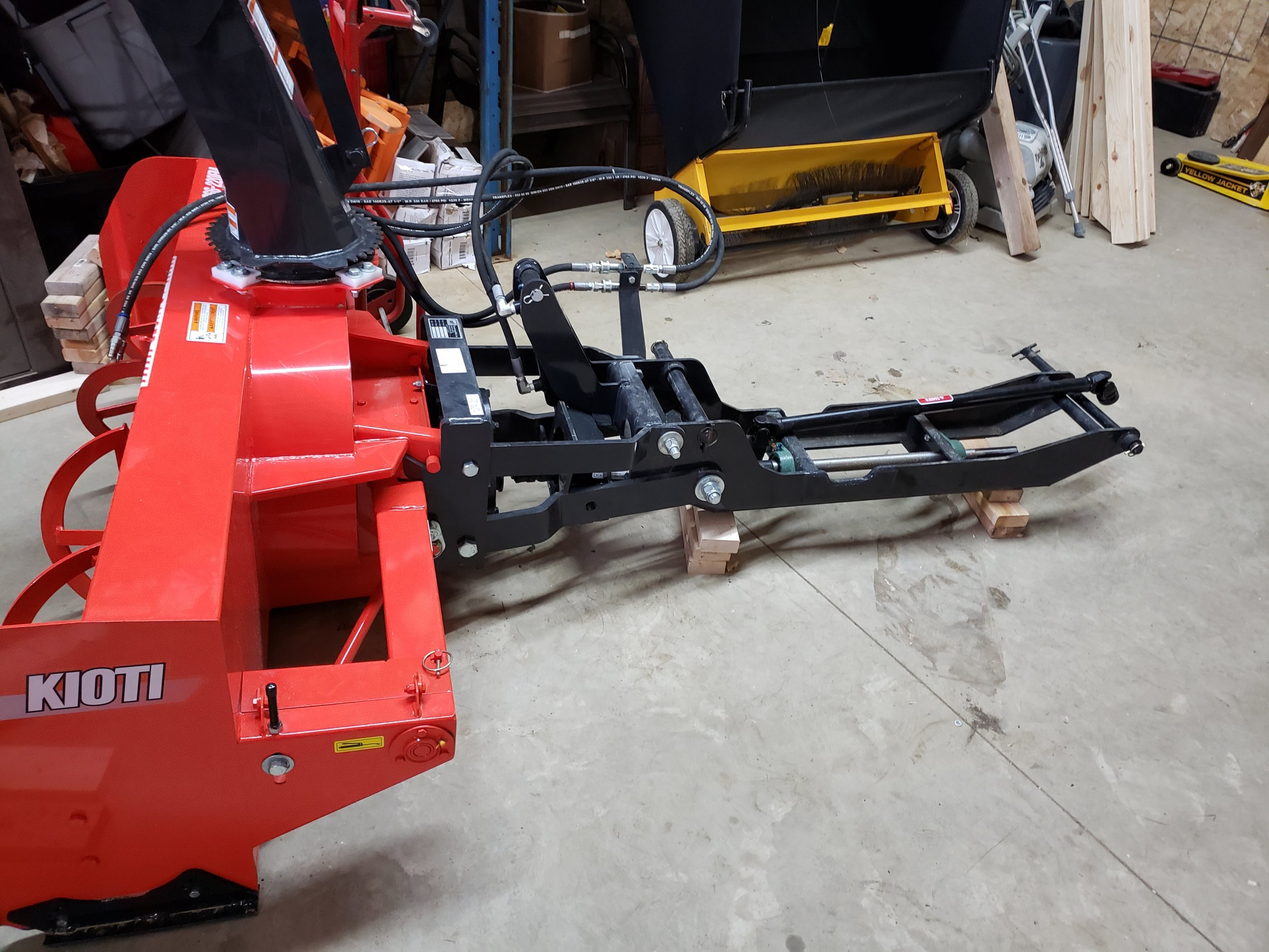

Thanks for getting back to me... Ok.. Here it is, I did mine with the help of my dad and uncle. Uncle was a farmer.. So literaly 2 pins, the PTO, and the hydraulics and I backed out of it. The whole thing came off in one shot. first pin is in front of front wheels and goes all the way across to other side, 2nd pin is under cab and it goes all the way across. (we braced it with 2x4's to relieve pressure) Ill post pics just in case later on this afternoon. They may help someone...
Thanks for the info, that's good to know. Makes me wonder why the manual instructs to remove them separately? Oh well, I like your way better. I'm thinking of building a "dollie" to lower it onto so I can move it around.
   / CK3510SEHC w/ Front Snow Blower First Impressions #17

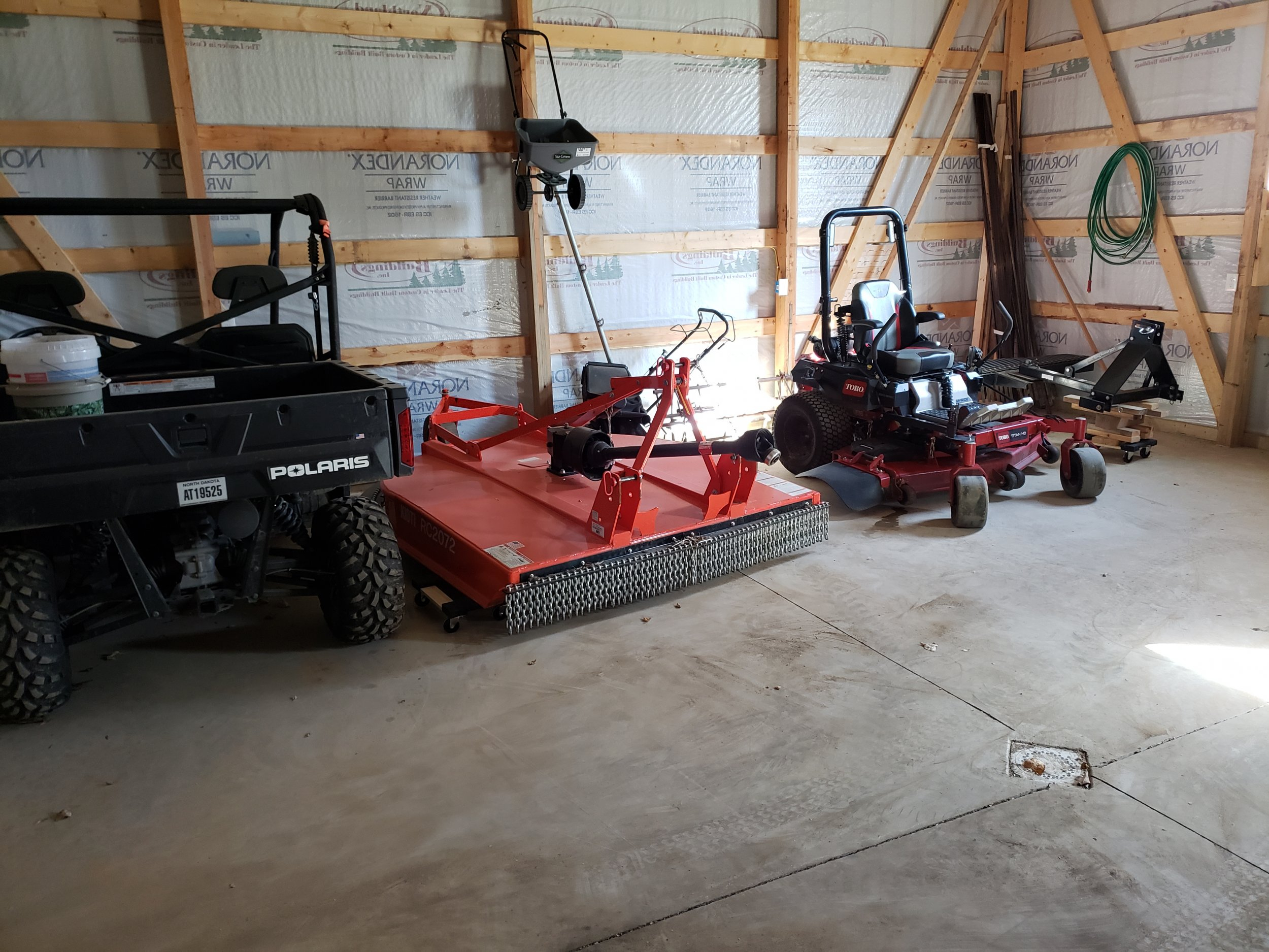

Thats the way i do it.. All my stuff is on dollies so i can move it... my rake, brush hog, etc.. I keep the forks elevated so i can drop the bucket under the table and grab the forks from above. Again I hope this helps anyone with a kioti set up..
