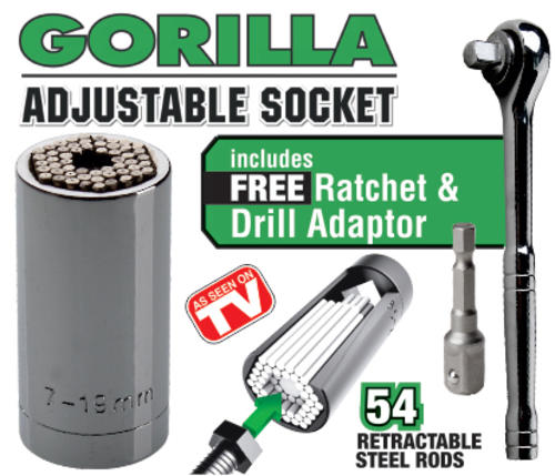

   / CK35 square sockets for drain plugs? #17
^^ Have you ever seen one of these? I have never used one and cannot recommend them, but for a situation where there isn't any great amount of torque involved, they might just work. I've seen them in a few places and under different names too.
Or they could be total junk.
#18
Depending on the price, I might be willing to try one! Could be useful when one encounters a truly oddball fitting... if it works!
