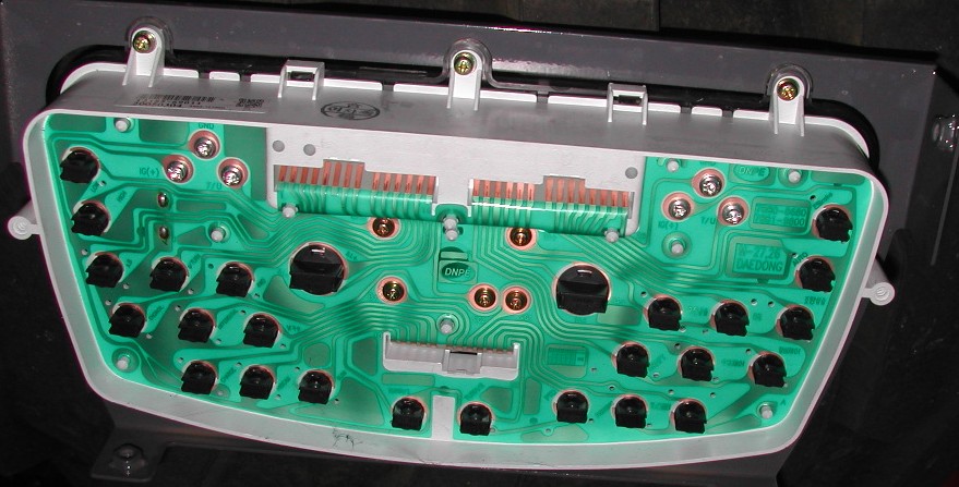

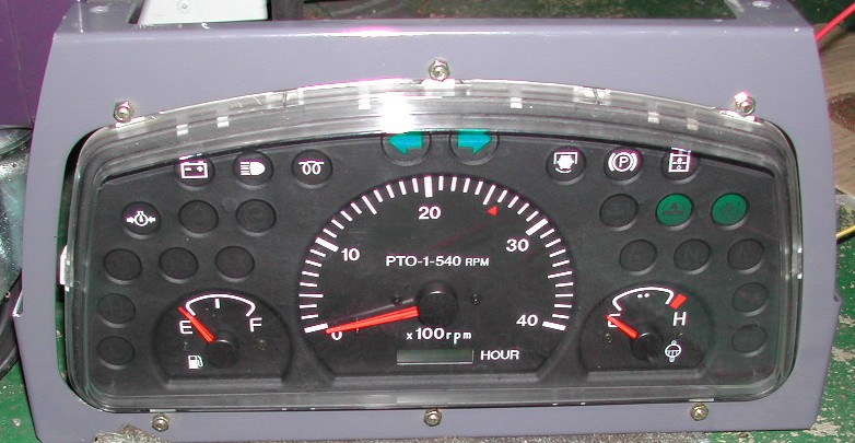

Seems like a big waste of money for Kioti to buy these really nice instrument panels and then most of it has no function.
I just reassembled my instrument panel, and yes, there are many warning
lights that are not used. Some have their names written on the PC board
in English, like "draft control". Others are in Korean, and my Korean is rusty.
I took a couple of pix and will post. I energized a couple of them to better
see what kind of symbol was there. I briefly considered using one or more
of them for indicator lights for my 2 solenoid hyd valves. Unfortunately, you
would have to add pins to the connectors, so I did not.
As for the manuals, they are not a lot of help in the wiring diagram area,
that's for sure.
TBN used to have a poster who was involved in editing the service manual.
(Where are you, KiotiJohn?)

Here are the photos I mentioned.
If you look closely at the back of the panel, you can see that this panel is
used for the M27 and M26 series tractors. The M27 is the CK25/30/35 in the
U.S. I do not know what other models are in included in the M27 series. I
suspect the M26 is the CK20. The DK tractors use a different panel, from
what I remember.
In the other photo, 2 of the "extra" mystery lights are lit up green.
/ CK30HST Instrument Panel #11
what I remember.
What is the light (not illuminated in your photo) directly below the headlight indicator?
/ CK30HST Instrument Panel #12
Sorry, I can not read the label even on the original photo, zoomed in. As TBD suggested, I would have tried translating them. Today, any AI can probably read and translate it if one can get a good photo.
If you remove your instrument panel, post what you find out here.
/ CK30HST Instrument Panel #13
From the service manual,
Coolant remaining warning lamp.
