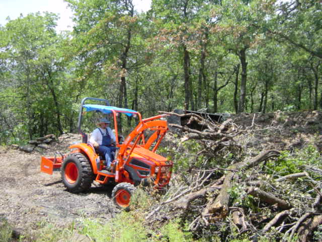

I've NEVER had to dump brush cause I couldn't lift it all, it's lifted everything I can cram on there. I don't think you'll be disappointed, I've been extremely happy with mine. I cram my 5' bush hog into some nasty stuff and have never bogged it down either. The rebar I hit was kinda hard on the blades, but it didn't bog down. /forums/images/graemlins/grin.gif
