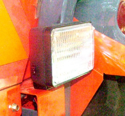

Here's a pic of the $15 work light installed. The kit included a lot of wire and a switch. I used a moto tool to cut a place for the switch on the light housing, snapped it in and secured it with black silicone. Connected the wires to the two smaller connectors, which are ON all the time the lights are on. The switch within the back work light housing allows you to turn the light off when you don't need it.

I can't tell exactly where you put it, but do you get good coverage of a work area, say backhoe work, etc.?
I made one on a magetic grounding block so that I can move it around where I need it.
It looks good.

It is in the mounting hole meant for the back work light, back right of tractor.
Actually I haven't used it yet, but it is plenty bright.

That should probably keep from casting your shadow on the work spot then if it's far enough off to the side. When you're on the backhoe, some light locations are not high enough up, or off to the side enough not to hit the operator.
