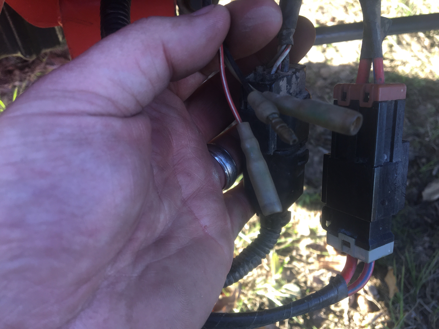

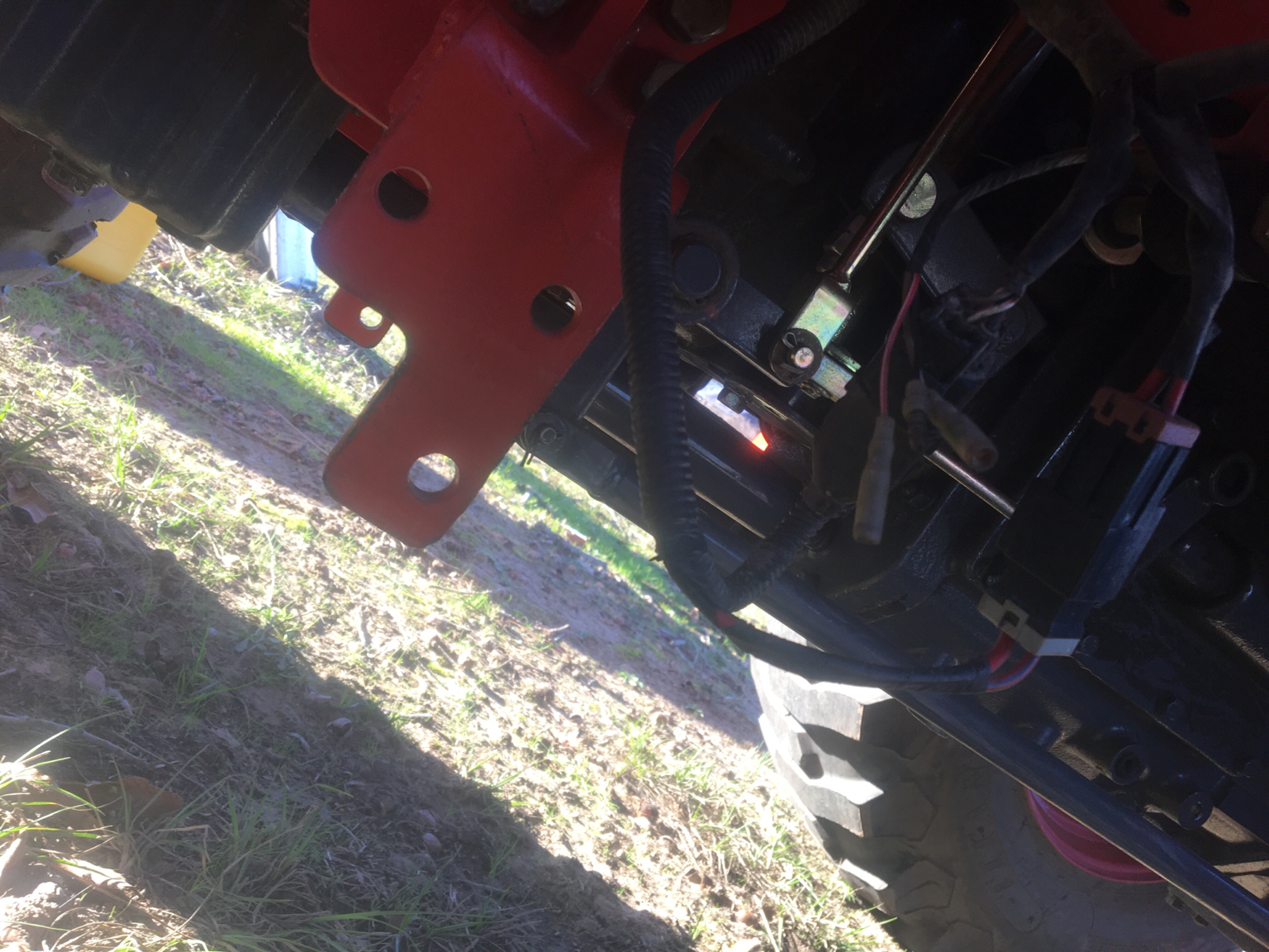

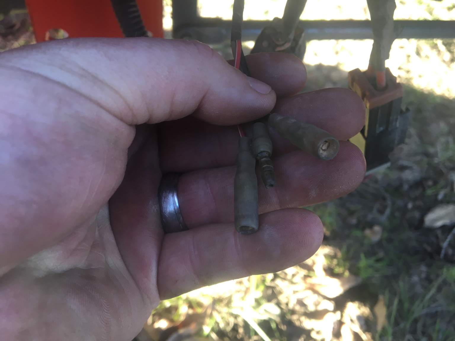

I was clearing some brush on Monday using brush hog and fel. Was pretty tough on it. When I got it back home I. Priced some sites hanging from under the left side. Don't think it was like this before. Can you guys tell if do egging is unplugged or out of place.

Does everything still work? Tractor start? If it starts then maybe you're looking at something having to do with lights (turn signals etc.).

The three "bullet" connectors are for the left marker/turn light. Look under and you'll see the other bullet connectors, match wire colors and plug together.

I have done the exact same thing. I believe they are for an option we don't have, maybe a cab power supply. If you look on the right side of your machine you will see 3 more in pretty much the same are. All my lights and signals seem to be working fine. I used cable ties to secure it up more solid.

The NX all seem to have a disconnected blue wire on the left side of the engine as well. Nobody seems to know what it's for either.
