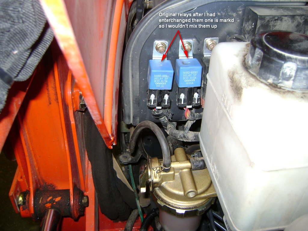

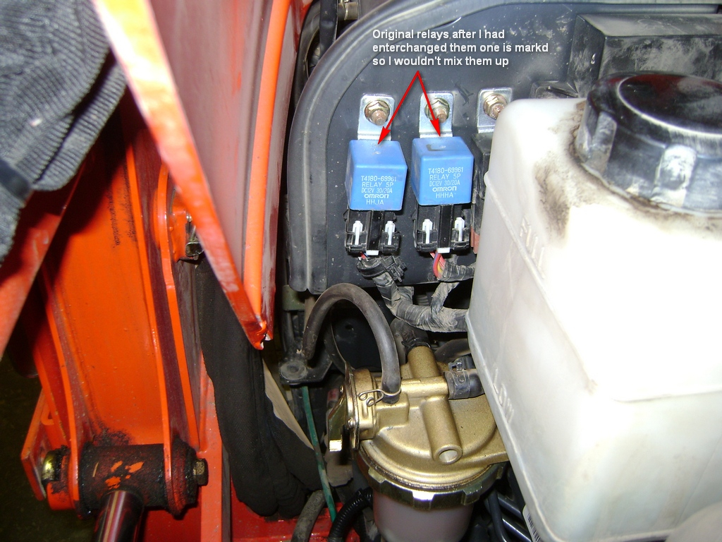

There are 2 relays on the fire wall this is a shot in the dark but put a finger on them ( maybe feel them activate ) and listen for a click when you turn the key on. Best of luck.
/ CK30 no dash lights or start... #3
Pop the hood and they’re on your left, or in line with the throttle lever, if you could look through them. Tap them lightly and try to start the tractor. It may be easier if someone taps and another person sits in the seat to try to start it. I replaced both recently with similar recurring issues and now have gone months without problems. See my thread just below this one. Update-Second time key switch…
/ CK30 no dash lights or start... #4

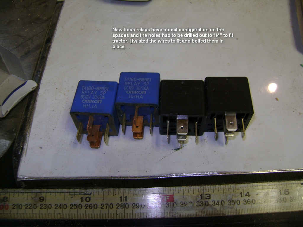

Pic may help if that's the problem. The first thing I did was interchange them, the tractor started so I knew the problem was isolated.
Owned the tractor another six yrs. with no problem.
