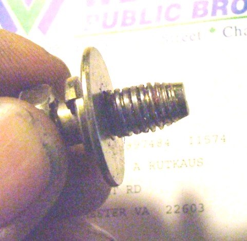

I was tightening the 6 12mm bolts holding the cover on the loader cross member and noticed that the two middle bolts were stripped and would not tighten. Picture attached.
5 of the bolts were loose and I could see how tightening them would strengthen the frame.
It is possible that the two center bolts being stripped is a coincidence, but that kind of stripping could also be caused by movement, so it might be a clue as to where some stress is.
Mike

I like your picture---one of mine became a two piece bolt while tightening.
I think fastener quality control may be lacking or its really a grade .05 ???

So do you think the welder will remove the hyd hoses from inside that cavity? I'll end up taking the cover off to check for melted stuff.
