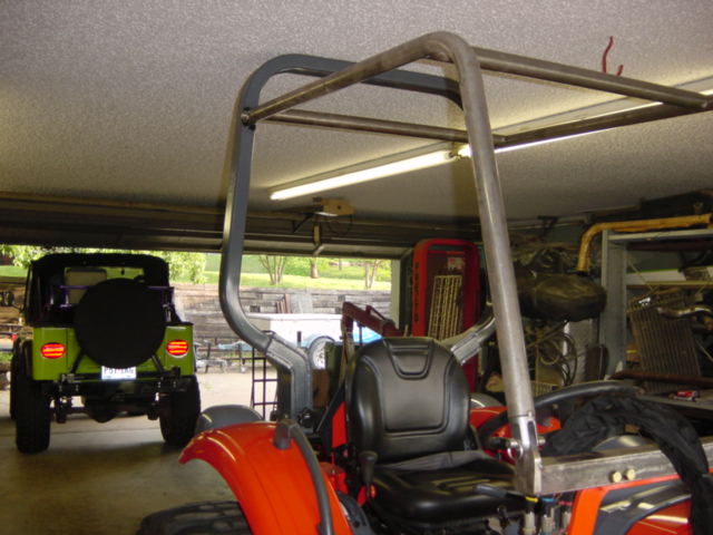

Here's what I've got started, it's just tacked together for now. I need to check out how it will fold down with the main bar laying flat before I sew it up.

Another shot

Looking good so far. How are you attaching it to the ROPS? Your not welding it, are you?
   / CK30 FOPS
Yep, I build cages for Jeeps, race chassis that I've flipped end over end, so I've bet my life on my welding a few times.

That looks pretty good - you must have a tubing bender too. From the pictures it looks like you have welded the upper mounts directly to the ROPS - but the lower mounts have the rollcage sidebar quick connects on them - why make the lower mounts disconnectable when the upper mount is welded right on? Keep the pictures coming - I have been thinking of something like this for my BX23 and you are giving me some ideas.....
   / CK30 FOPS #6
<font color="blue"> From the pictures it looks like you have welded the upper mounts directly to the ROPS </font>
That's what I was thinking too Jim, but now my guess is that it is just resting against the ROPS...

The top has a clevis like the bottom, when I pivot the Rops back after disconnecting the front, it should pivot down enough to clear the garage door. I'll put a stop on there somewhere to keep it off the fenders.
