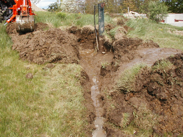

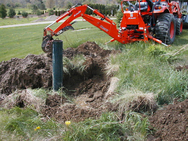

I have been out of town for 4 days, I was wandering around my property with my dog and just down hill from my well head the ground was soaking wet, puddles even!!?? I have lived here for 5 years and I have never seen it wet there and it has not rained for 2 weeks!! :eek: This can't be good. The ground was wet up to the well head. In the house, the pressure tank was at 50psi, the shut off is at 60psi. Twenty minutes later it was still at 50psi, pump still running, no water running in the house!!?? Shut off the pump and got out the CK30, I had just put the BH back on last week, and started digging. Ground was a sloppy muddy mess. The Kioti saved my back... or my checking account. :) Pipe connection was down over 4ft, I need to get the rest of the water out to see just what sort of a mess I am up against.

/ CK30 BH being put to work #2
Bummer about the well. At least you got a chance to use the tractor so I guess there's always a bright side. Hopefully it's a simple fix once you dig it out of all that soup.
Dave
Well... I finally got down thru the water mud and muck to the pipe coming out of the well head. The 1" black well pipe is insulated and run inside a 4" PVC pipe. Unfortunately the leak is not at the well head, :( it is somewhere up inside that 4" PVC pipe. So I am presently digging back up the pipe trying to find the leak. It is 150' from well head to the house... I hope I don't have to dig the whole thing, especially since there is a shed sitting on the path between the well head and the house and that would have to be emptied and moved!! :eek: A contractor friend stopped by and suggested I just start digging from the house end of things as the chance of the well pipe breaking inside the PVC pipe is VERY small. At least I now have a few hrs of BH use so I will feel more comfortable digging next to the house. :)

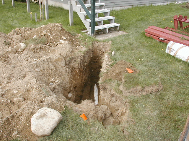

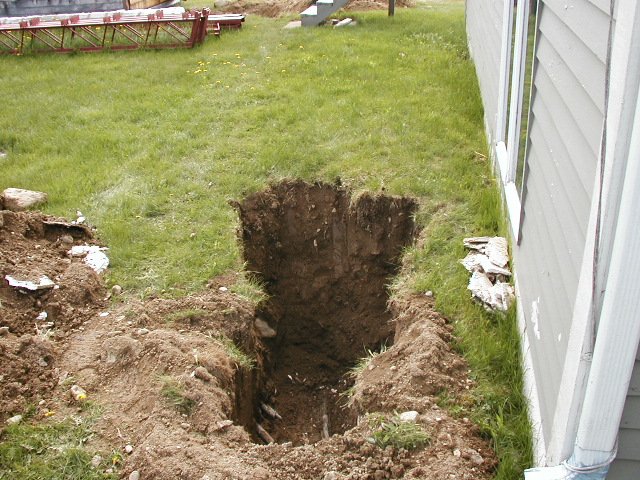

#9
The digging continues. The shed does not have to be moved. :) The sleeve is not foam filled. :) I have been digging down to the water line every 30' or so, cutting a small hole in the side of the sleeve, turning on the pump to see if there is water flow at that point in the sleeve. I went back to the house and dug a hole there, at this point the water line and electrical line are not in a sleeve, they were covered with 1" of styrofoam. :( Sighting the sleeved line and the non sleeved line back to a point they intersect puts us under the concrete slab for the porch steps. :( More digging today.

/ CK30 BH being put to work #10
:( buried water line problems :(
Hope the prob isn't under the slab, grrrr.
So much is dug up, and the digging continues, that Highbeam's suggestion to replace the old waterline is worthy. Maybe attach a new direct-bury PVC flex waterline to the old one and draw it through the sleeve . . .
You're getting a workout, good thing backhoes were invented for us :)

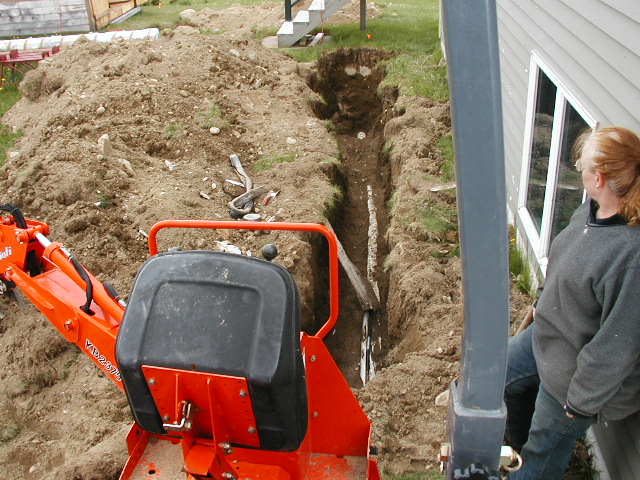

Problem found, and temp patch put in. :D
About 3' from the end of the sleeve, the sleeve was crushed, it also crushed the well pipe inside it. After 28 years the well pipe finally split. The split is where the duct tape is in the picture. The DT was used as a temp patch to get enough water in the house to get cleaned up for lunch. Neighbor had all the fittings and pipe to put in a real temporary patch. It does look like the old well pipe is the thin wall stuff. Neighbor had the thick wall that I used for the patch. Presently it is holding, I needed to head to Boston an hour ago for work... so the permanent fix, whatever that will be, will have to wait until I get back next week. Thanks for all your thoughts and encouragement, it was a bit frustrating at times. At least I am now comfortable operating the BH within a foot of the house. :) In the mean time... I will look into Rex's suggestion of the direct bury PVC water pipe.

/ CK30 BH being put to work #12
I first read "the well pipe split" and thought oh no, that is the worst news. Then saw from the pics that it was the water line from the well, not the wellpipe in the well casing. Whew.
Replacing the whole line is a good idea Jim, a direct-bury potable water PEX (blue poly) or PE (black poly) flexible water line is I think the longest lasting, easiest and cheapest. I buried ~200ft of 1-inch flex black poly, connected from the wellhead to the shop and house, it takes just a few materials: a union coupling from the well's metal pipe to the poly pipeline, a coupling at your house waterline, a handsaw to cut it, and stainless steel hose clamps like you use on radiator hoses. If you need to splice poly lines together use two of the s/s hose clamps on each side of each fitting to ensure no seepage. Sweeps aren't needed because the line is flexible. Under the gravel driveway I ran it through 2" SCH80 PVC conduit on a sand bed, to keep rocks in the dirt from eventually working down and abrading it.
