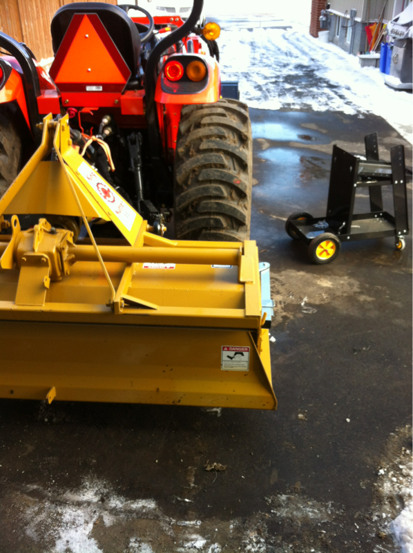

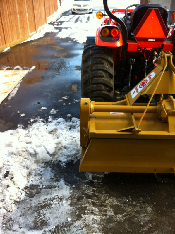

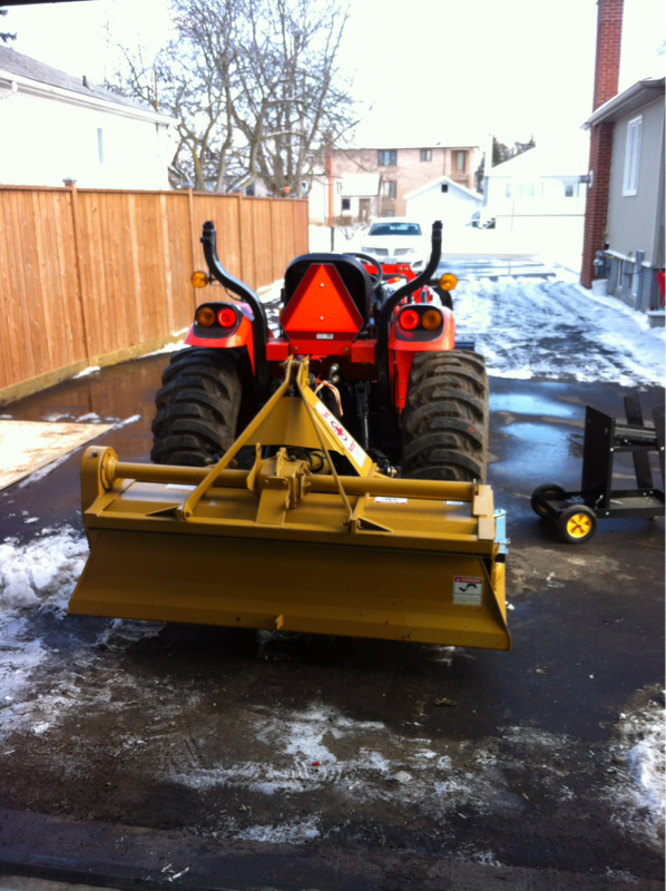

FYI I am back and have the tiller mounted on the tractor. Believe it or not the tines are offset by about 4" to the right side. That's because the gearbox is about 4" thick and added onto the left side. If that makes sense.
   / Ck27hst, r4's and tiller.
#19
Ok here are some pics.
So imagine this. They build the frame that houses the tines. Then they add the gearbox to one side. Then that measure the center point of the whole thing and weld the hitch mounts. So the whole unit is centered but the tines are slightly offset.
