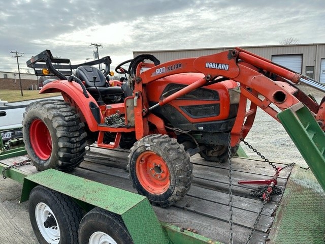

Took on a project for a good friend of mine, the shuttle locked up on his CK27. It has 805 hours on it. Gave it a bath and got it in the shop. Started taking sheet metal off. Anybody else been through this with theirs?
I've got the 402 page workshop manual for it.

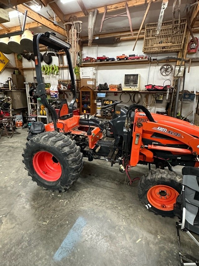

We gonna try and figure it out.
The front trans drain plug.
The rear trans drain plug.
Getting it separated.
Pretty sure the culprit is in here.
/ CK27 Shuttle locked up......
This was the problem. The shuttle lever was stuck, this slider had a burr on it all the way around and was stuck on what it slides on. Can't get it out without splitting and removing the trans. Took a small grinding stone on the dremel and fixed it.
