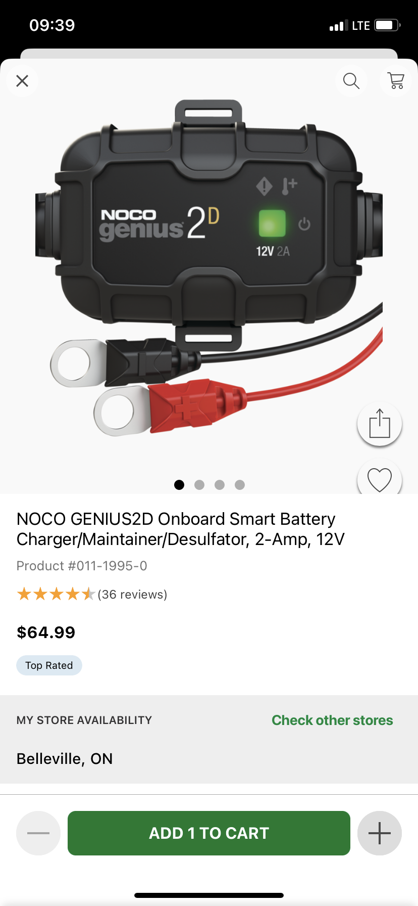

I use a NOCO battery maintainer on my CK30HST like in the picture. Various models Available at Canadian Tire. We just had this extreme cold in Ontario and we sent it your way. 😉 I mounted this unit near the battery and the power cord sticks out from under the front grill, Plugged in 24/7
I bought one of those on a whim and I gotta say -- It kicks butt!
Make sure you get one powerful enough for your batteries. I used it on my Wife's car, which has a good-sized AGM battery, I was impressed. Brought it back from the half-dead after sitting for 4 Months.
I have two of them now.
I have the big expensive NOCO Genius and it will start my 3406 Cat when the starting batteries are low, no issue. Ain't cheap however. Mine recharges on 110 or on a computer connection but the computer takes forever. Great units far as I'm concerned.
