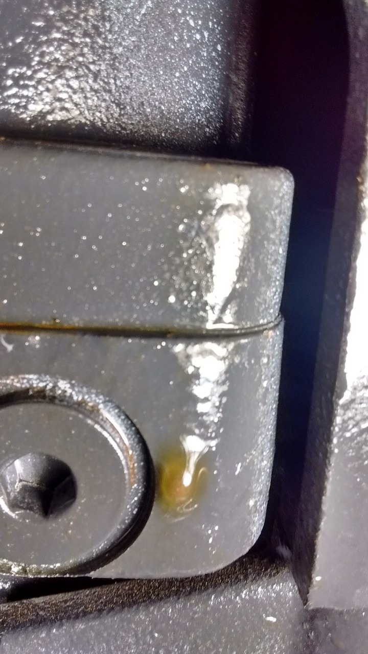

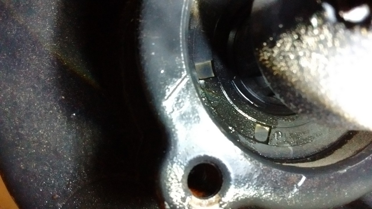

I have 48.7 hours on new CK2610H. Was wondering if other owners of this same model have experienced hydraulic leaks? How hard they have pushed the machine, how many hours w/o leaks, or problems?
The seal where 4x4 shaft goes into rear transfer case was replaced by dealer once under warranty, and it is leaking again. Dealer is coming out the look at it.
Have another leak looks like coming from drive train and dripping on 4x4 shaft. Have photo if needed.

I would have them confirm the casting where the seal goes is ok. A few people have had bad castings with voids and where it was machined for the bearing and seal opened up the void. Once this happens there is no good way to seal it besides replacing the casting.

Sadly, do not assume that the dealer performed a proper repair. I had a leaking rear axle and the dealer resealed under warranty. They resealed BOTH sides even though one side wasn't leaking. Now, after shy of one year (about 100 hrs) that one side is leaking (tractor is now at their shop). This current leak cannot be blamed on the factory, only on the dealer.

OP, post pic; its always useful to show pics.

Thanks for your responses. Sorry have not replied sooner. I need to change alert settings.
Ok Diesel Bound.. I will post here and your link. Dealer "said" he has not heard this was a common problem.
Attached is photo of leak after repair. Also pic of new leak that has developed.
Leaks on new equipment one pays so much $$ just drive me nuts!
I am hoping the seal was just installed incorrectly, or there is a burr on shaft, or similar.
