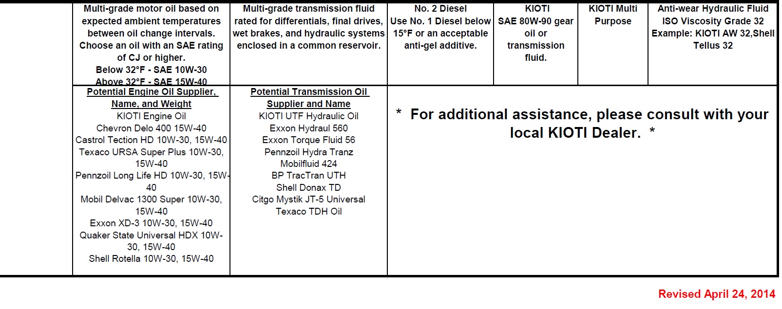

It would be interesting to know what oil they used at the dealer you purchased the tractor from. I've run into a dealer that was using an oil not even on the kioti list (see below), but because it was cheap they went for it.
* So it may be a possibility that the oil in your transmission is not correct for your application.
* Do you have any remotes that may be accidentally engaged? I know the DKse series tractor remotes can be easily bumped on, and deadheading without the operator knowing, causing sluggishness.

That dealer is no longer in business, for this reason and others. But I thought I should mention it. I personally use Traveller Premium Universal Trans/Hydraulic Fluid, made by Warren. Its not on the list, but most Oils rated for transmissions, final drives, wet brakes and clutches, and hydraulics that are supplied from a common fluid reservoir will work just fine, so long as they meet regs and specs for your tractor.
