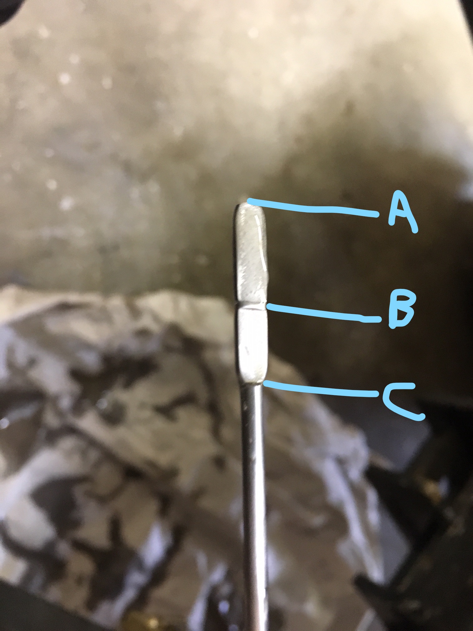

Also a reply to an old thread but the most applicable. I completed the 50hr service and am refilling the hydraulic fluid due to the loss when changing the filters. My guess is I lost around 1 gallon.
In the manual, the acceptable level is shown as between the bottom of the dip stick and the first line as the picture shows attached. However, the oil dipstick/cap looks the same as the one manual shows for the front axle that has a high mark of the plug itself.
So do I fill between the two bottom lines (A and B) or do I fill closer to the actual plug like the front axle?

B in your second picture (top row) is the full line
