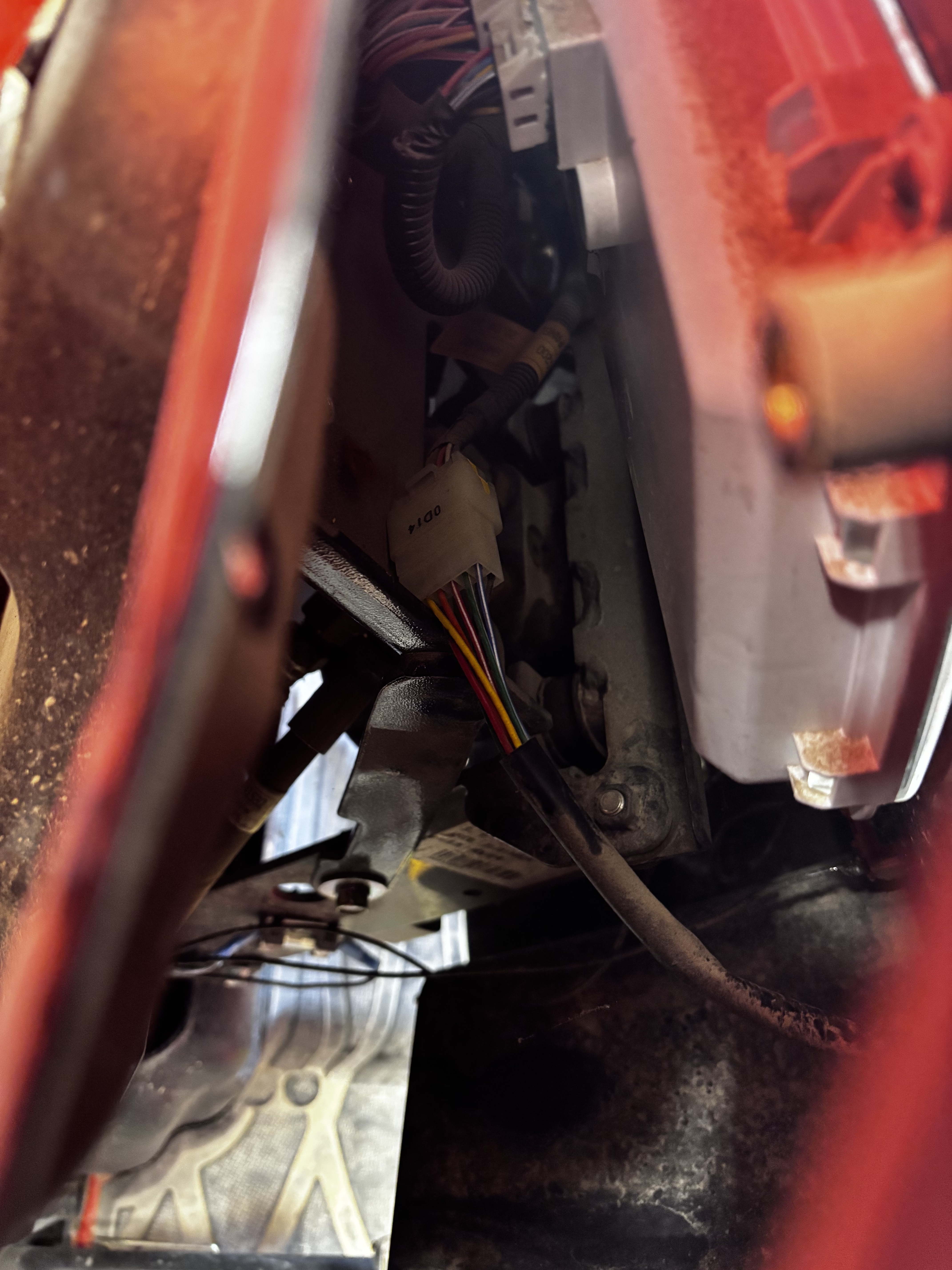

Headlight and related lighting would not come on and was continuously blowing fuses . checked fuse socked and it was shorted to ground . Troubleshooting brought me to the headlight switch . When i was removing this switch the harness / connector was laying on sharp part of the frame and this is where it was shorted . No insulation between harness and frame .. Hope this helps someone with similar issue with light switch .Not the best pic but the white connector is in middle of pic .. this is behind the dash ..View attachment IMG_6060.jpeg

If you’re referring to the link to the pic … sorry don’t know how else to share..

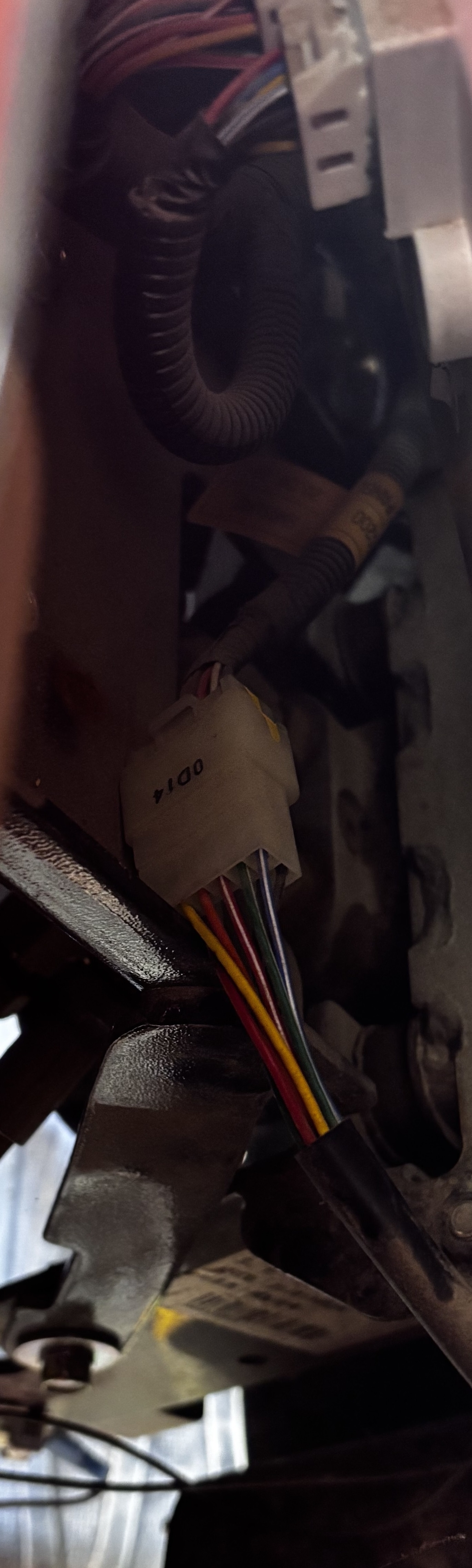

Here it is, cropped down.
