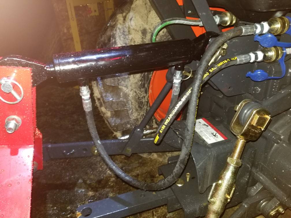

This valve kit has a spring valve spool and a detent valve spool. Will the top link work with either the spring or detent valve spool? Is there a reason to use one over the other? TIA
   / ck2610 dual rear remote valve kit dealer installed #2
It will technically work with either, but I壇 use the spring valve. Way easier to adjust
   / ck2610 dual rear remote valve kit dealer installed #3
I have same kit. I run mine on the spring one. Have them make a loop up for your detent one. My dealer does this so that if it gets moved to engaged it wont burn your pump up when nothing is attached. (You can see the top of the loop behind my top link) 20180412_194204.jpeg
   / ck2610 dual rear remote valve kit dealer installed #4
Double post
   / ck2610 dual rear remote valve kit dealer installed #5
Does the detent not spring back to center if you don't push it all the way to the ends?
