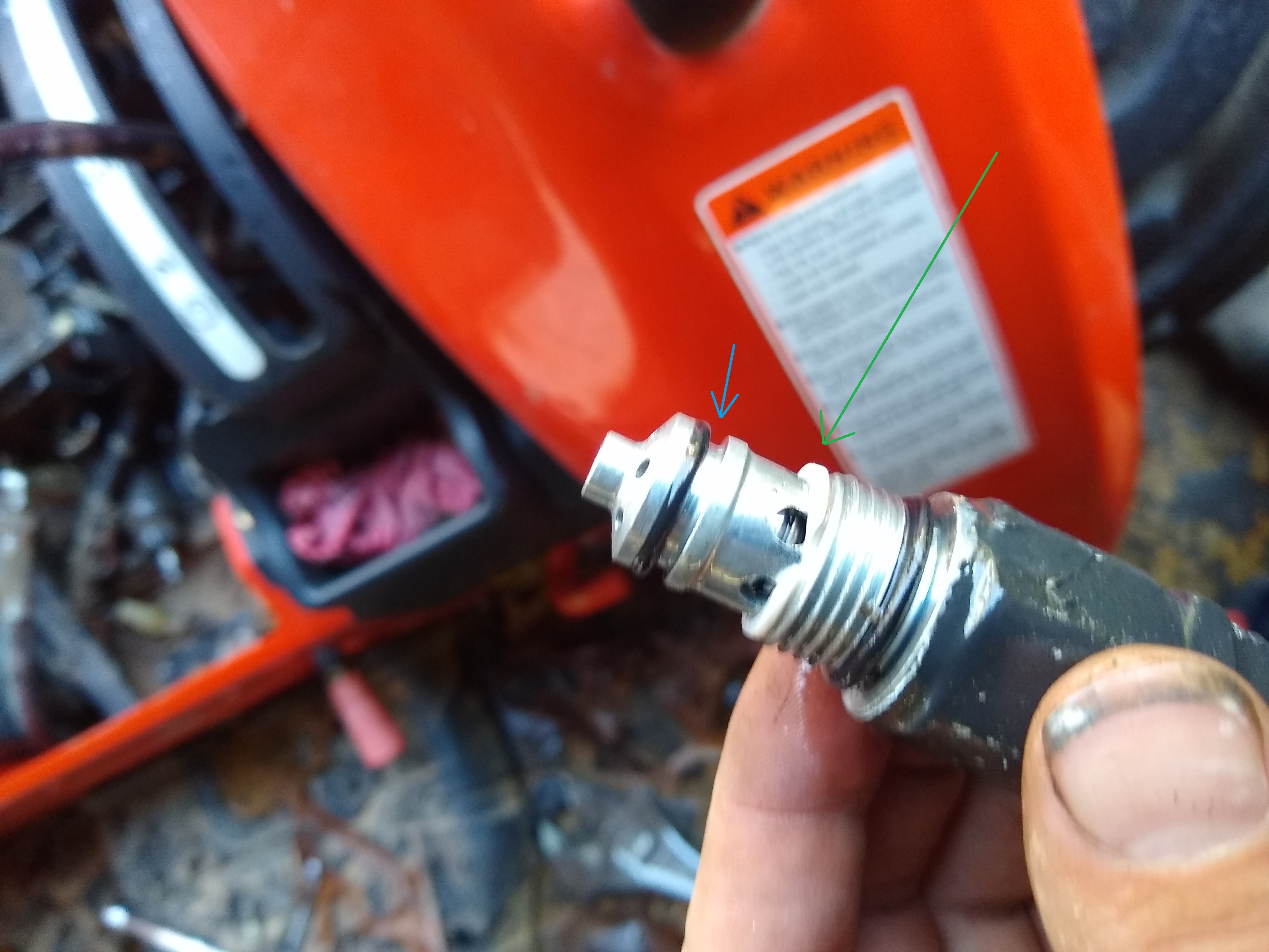

My 2610's 3pt hitch would leak down pretty fast. After running the tractor for a while and getting the hyd oil hot, with a heavy implement on the 3pt hitch you could sit and watch it pulse up and down as it would drop down and the position control would return it to where it was supposed to be about every 2 seconds.
I closed the speed control valve under the seat, shut the engine off, and it would sit there and creak away every couple seconds as it would continue dropping down.

So they blame the problem on me adjusting the speed control valve and it would take a month before they could get it looked at. I wrote these guys off immediately.
I couldn't find a shop manual on this tractor to see the hydraulic circuit diagram so I had to do some looking myself.
I was curious about the positioning of the relief valve in the hydraulic circuit. Maybe it was partially stuck open? I removed it and found that it is located in between the speed control valve and the cylinder for the 3pt arms, as would make sense to protect from overpressure even if the speed control valve was completely closed. Turns out the back-up ring was installed incorrectly (see where it is with the green arrow in the picture), and the rubber o-ring was by itself and didn't have the necessary support of the back-up ring and fluid would bypass the o-ring causing the hitch to leak down. I'm unsure if the backup ring is supposed to have the split in it for installation purposes, or if mine is broken, but I just moved it down next to the o-ring where it's supposed to be (blue arrow) and... problem solved. Glad I didn't have to pull the whole lift arm assembly. I looked on MIE's parts diagram and it shows the relief valve (Parts Finder Michigan Iron & Equipment Morrice, MI (855) 265-459), but no o-rings or backup rings, so I'm not sure where I could get a replacement just to have around in the future if my backup ring is actually broken and it leaks again.

Yeah mines been doing fine since, left the 3pt all the way up and it took about 2 days to leak down with land leveller on it. Good enough for me!
/ CK2610 3pt leak down fixed #5
That is a standard back up ring. They have that beveled split in them for assembly.
Sometimes people don’t get the beveled ends to overlap correctly and that can cause problems as well.
