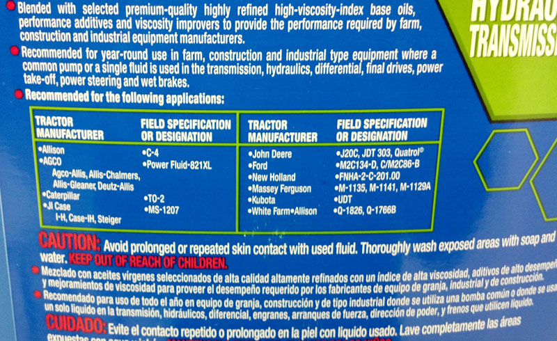

Thanks for checking in with me. Work was really busy for me so I put this to one side for a while. I've been buying tools like a 21MM wrench and trying to find the right transmission fluid. And that is what I need help with. The tractor manual says these fluids work:
Mobilfluid 423 or 424
Exxon Hydraul 560
DONAX-TD/TD Plus
Tractan UTH
I've been to stores like Wal-Mart, Tractor Supply and Shipton's Big R and no one has any of this fluid. I found some fluid at Wal-Mart that listed a bunch of tractors on the back. I've uploaded a picture below:
Will this fluid work? If not, where is a good place to buy this fluid? I don't want to take the tractor apart until I have everything I need to put it back together in working shape.

The Shell Donax TD has been renamed to Shell Spirax. Most of the time, you have to go to an oil supply place to get those listed. Sometimes NAPA will carry one of those listed and members have posted some Walmarts carrying those brands but my local Walmart is like yours. As far as tractor supply center, members have posted that the TSC "premium" hydraulic fluid works well. TSC also has a standard hydro fluid and I have also seen the Mystic hydro fluid there sometimes. The oil needed in general is a 10W-30 multi weight hydro oil that is for common sump, wet brakes, transmission, differential, and hydraulic pumps. The Walmart oil looks like it would work but members have posted good service with the TSC oil. Unless you are going to change your oil, you'll probably only lose a quart or so. TSC sells it in 1 and 5 gallon containers. It takes 8 gallons for a full fill after drain and filters.
Yes it will work. I've used it before in my DK 35. Works fine.
A heavy duty tractor hydraulic/transmission fluid compatible with wet brakes should be fine.

The hoses should mount up as long as they can pivot to meet the wider cooler and the ends mount flat on the cooler. That chart was posted a while ago by another member. Sorry, I can't remember who to give the credit.
If Vince has used that Walmart fluid in his tractor, then it would work. He probably has well over 1,500 hours by now. Also, he clued me in years ago on the 5W-40 synthetic engine oil, Shell Rotella, that makes for easier starts in this nasty Winter cold.
I hope all goes well.

Thanks for the tip. I bought a gallon and started work.
