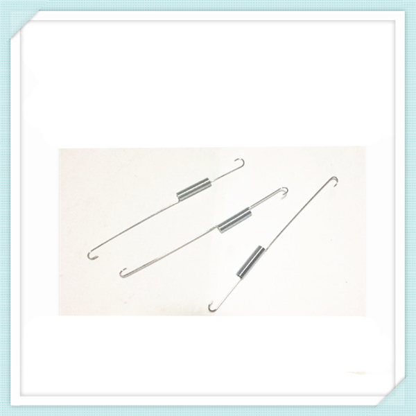

Hey good luck with it. You need the dexterity of a heart surgeon but keep at it. I fabricated a flexible spring pick out of a light wire spring similar to these.
